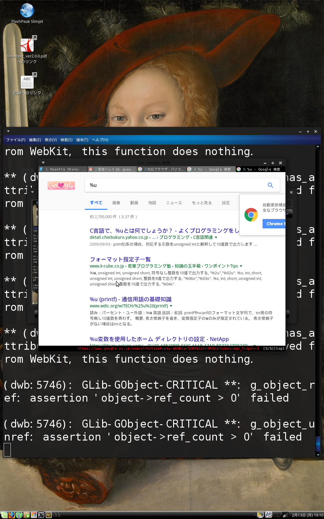

さっき、操作中に誤って 変なキーを押してしまったら、dwb が異常終了し、再度起動させようとしても、「一瞬 何かが見えて、すぐ消える」
Synapticで完全削除指定>再インストール>改善しない
As earlier, if you accidentally pressed a strange key during the operation, dwb ended abnormally and even if you tried to start it again, "something appears for a moment and disappears"
Specify complete deletion with Synaptic> Reinstall> Not improve

Mint 17.2 uses an Ubuntu 14.04 package base.寺島聰子 写了:OS の状態の善悪を、判断するヒントは、どこを見るのでしょうか?
一年間使いつづけた。Mint17.2。
Before starting dwb, open a terminal window and execute
sudo tail -f /var/log/syslog
Then start dwb in another terminal to catch any exception it may throw out.
Try deleting dwb's user config dir located at ~/.config/dwb寺島聰子 写了:「一瞬 何かが見えて、すぐ消える」
Make sure to backup stuff such as bookmarks or history.
mv ~/.config/dwb ~/.config/dwb-orig
sudo apt-get update
sudo apt-get purge dwb
sudo apt-get install dwb
See also:
https://bugs.launchpad.net/ubuntu/+sour ... ug/1550493
https://bugs.debian.org/cgi-bin/bugrepo ... bug=820351

既にdwb は削除してあったのだが、作業前に もう一度インストールした。
I already deleted dwb, but I installed it again before work.
英文
I can not understand this part
m@m ~ $ dwb %u
dwb を起動したとき、今回は、前回の症状はなく、正常起動しているように見える。
When dwb is started, this time there seems to be a normal start without the previous symptoms.
英文
この部分が理解できませんto catch any exception it may throw out.
rom WebKit, this function does nothing.
略
** (dwb:5624): WARNING **: webkit_dom_node_has_attributes: this functionality has been removed from WebKit, this function does nothing.
(dwb:5624): GLib-GObject-CRITICAL **: g_object_ref: assertion 'object->ref_count > 0' failed
(dwb:5624): GLib-GObject-CRITICAL **: g_object_unref: assertion 'object->ref_count > 0' failed
略

最初、言われている意味が理解できませんでした。Synapticに存在してるのに1-1. It means that dwb was not included in the official repositries of Linux Mint.
2. Suggest For new user :
You had better use the software packaged in the system you are just operating now for the purpose of better support.
なぜだろう?と。
At first, I could not understand the meaning being said. Why is it present in Synaptic?
https://www.howtoinstall.co/en/ubuntu/trusty/dwb
sudo apt-get update
I installed this by typing this command? I do not have it in memory.
apt-get update
apt-get purge <package_name>
>dwb is a web browser without active upstream. Since nobody answered to #811405,Note that the package 'dwb' has been removed in recent releases of debian and ubuntu/mint, probably because its development has been stalled for a long time and it deemed too unstable to be accepted.
See also:
I'd rather have dwb removed from the archive than keep a unsupported browser. So
please remove dwb from unstable.
大変参考になりました。ご指導ありがとうございました。完全動作は期待せず、クラッシュしても「こういうものなんだ」と思い、一種の諦観をもって 使っていきます。
「Keyboard のみの操作」という自分にとって楽しく、かつ稀有の機能ゆえに、完全に手放すことは できませんが。。。
It was very helpful. Thank you for instraction. I do not expect complete operation, even though I crash, I think that it is "such thing", I will use it with a kind of resignation.
Although I can not let go of it completely, due to the fun and rare functions of myself "Keyboard only operation". . .
