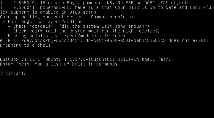

请教各位,用make dpkg 打包内核后,安装出现这个是什么问题呢

重新编译了内核,打成包,安装后,出现在这样的画面

:em20 :em20 :em20 不知道楼主在编译的时候修改了什么参数?是不是默认参数?
那个CPU的应该有点问题吧,可能需要修改一下
还有,那个根分区找不到,请检查一下grub的配置
还有,可能需要检查一下文件系统模块的支持,记得这个问题我遇到过几次,都是忘记把文件系统模块编译到内核,结果导致当机

楼主能不能把Processor type and features->Processor family和File system一些修改的地方贴出来看看,尤其要确定一下File system里面有没有把你正在使用的文件系统类型勾上去了,推荐不要编译到模块,最好是编译到内核去

Processor type and features->Processor family配制如下:
   [*] Tickless System (Dynamic Ticks)                                                                  x x
  x x                              [*] High Resolution Timer Support                                                                    x x
  x x                              [*] Symmetric multi-processing support                                                               x x
  x x                              [*] Enable MPS table                                                                                 x x
  x x                              [ ] Support for big SMP systems with more than 8 CPUs                                                x x
  x x                              [*] Support for extended (non-PC) x86 platforms                                                      x x
  x x                              [ ] AMD Elan                                                                                         x x
  x x                              [ ] Moorestown MID platform                                                                          x x
  x x                              [ ] RDC R-321x SoC                                                                                   x x
  x x                              [ ] Support non-standard 32-bit SMP architectures                                                    x x
  x x                              <M> Eurobraille/Iris poweroff module                                                                 x x
  x x                              [*] Single-depth WCHAN output                                                                        x x
  x x                              [*] Paravirtualized guest support  --->                                                              x x
  x x                              [ ] paravirt-ops debugging                                                                           x x
  x x                              [ ] Memtest                                                                                          x x
  x x                                  Processor family (Opteron/Athlon64/Hammer/K8)  --->                                              x x
  x x                              [*] Generic x86 support                                                                              x x
  x x                              [ ] Supported processor vendors  --->                                                                x x
  x x                              [*] HPET Timer Support                                                                               x x
  x x                              [*] Enable DMI scanning                                                                              x x
  x x                              (2) Maximum number of CPUs                                                                           x x
  x x                              [*] SMT (Hyperthreading) scheduler support                                                           x x
  x x                              [*] Multi-core scheduler support                                                                     x x
  x x                              [ ] Fine granularity task level IRQ time accounting                                                  x x
  x x                                  Preemption Model (Voluntary Kernel Preemption (Desktop))  --->                                   x x
  x x                              [*] Reroute for broken boot IRQs                                                                     x x
  x x                              [*] Machine Check / overheating reporting                                                            x x
  x x                              [*]   Intel MCE features                                                                             x x
  x x                              [*]   AMD MCE features                                                                               x x
  x x                              [ ]   Support for old Pentium 5 / WinChip machine checks                                             x x
  x x                              <M> Machine check injector support                                                                   x x
  x x                              [*] Enable VM86 support                                                                              x x
  x x                              < > Toshiba Laptop support
                                     < > Dell laptop support                                                                              x x
  x x                              [*] Enable X86 board specific fixups for reboot                                                      x x
  x x                              <M> /dev/cpu/microcode - microcode support                                                           x x
  x x                              [ ]   Intel microcode patch loading support                                                          x x
  x x                              [*]   AMD microcode patch loading support                                                            x x
  x x                              <M> /dev/cpu/*/msr - Model-specific register support                                                 x x
  x x                              <M> /dev/cpu/*/cpuid - CPU information support                                                       x x
  x x                                  High Memory Support (off)  --->                                                                  x x
  x x                                  Memory split (3G/1G user/kernel split)  --->                                                     x x
  x x                              [ ] PAE (Physical Address Extension) Support                                                         x x
  x x                                  Memory model (Flat Memory)  --->                                                                 x x
  x x                              [*] Allow for memory compaction                                                                      x x
  x x                              -*- Page migration                                                                                   x x
  x x                              [*] Enable KSM for page merging                                                                      x x
  x x                              (65536) Low address space to protect from user allocation                                            x x
  x x                              [*] Enable recovery from hardware memory errors                                                      x x
  x x                              < >   HWPoison pages injector                                                                        x x
  x x                              [ ] Transparent Hugepage Support                                                                     x x
  x x                              [*] Check for low memory corruption                                                                  x x
  x x                              [*]   Set the default setting of memory_corruption_check                                             x x
  x x                              (64) Amount of low memory, in kilobytes, to reserve for the BIOS                                     x x
  x x                              [ ] Math emulation                                                                                   x x
  x x                              [*] MTRR (Memory Type Range Register) support                                                        x x
  x x                              [*]   MTRR cleanup support                                                                           x x
  x x                              (0)     MTRR cleanup enable value (0-1)                                                              x x
  x x                              (1)     MTRR cleanup spare reg num (0-7)                                                             x x
  x x                              [ ]   x86 PAT support                                                                                x x
  x x                              [ ] EFI runtime service support                                                                      x x
  x x                              [*] Enable seccomp to safely compute untrusted bytecode                                              x x
  x x                              [ ] Enable -fstack-protector buffer overflow detection (EXPERIMENTAL)                                x x
  x x                                  Timer frequency (1000 HZ)  --->                                                                  x x
  x x                              [ ] kexec system call                                                                                x x
  x x                              (0x1000000) Physical address where the kernel is loaded
                                  -*- Support for hot-pluggable CPUs                                                                   x x
  x x                              [ ] Compat VDSO support                                                                              x x
  x x                              [ ] Built-in kernel command line                                                                     x x
File system 配制如下

这边的配置都没有问题啊,内核怎么会提示找不到分区呢?应该是GRUB的参数有问题吧,试一下把那个UUID的形式修改为/dev/sdaX的形式看看
还有Processor type and features下面的Processor family是通用架构还是AMD的k8?
还有那个电源管理里面怎么有个powernow出现?
最后问一下,你的cpu是……

YeLee 写了:这边的配置都没有问题啊,内核怎么会提示找不到分区呢?应该是GRUB的参数有问题吧,试一下把那个UUID的形式修改为/dev/sdaX的形式看看
最后问一下,你的cpu是……
我的cpu 是 amd athlon 64 的,那个powernow 是cpu节能工作的

编译优化 :em06 :em06 :em06 这个词有点不是很适合,手动编译一般都需要去注意文件系统,电源管理和驱动这几个项目
一般文件系统这里我只编译自己需要用到的文件系统,那些根本用不到的就不去弄
电源管理这些主要是节能的问题,只把适合自己cpu的弄进去,其它的都删掉
驱动的问题,都是只把自己机器的驱动编译进去而已,其它驱动以后真的要用到就编译成模块
最后是cpu的问题,我只选择自己的电脑的配置,把其它选项直接干掉
