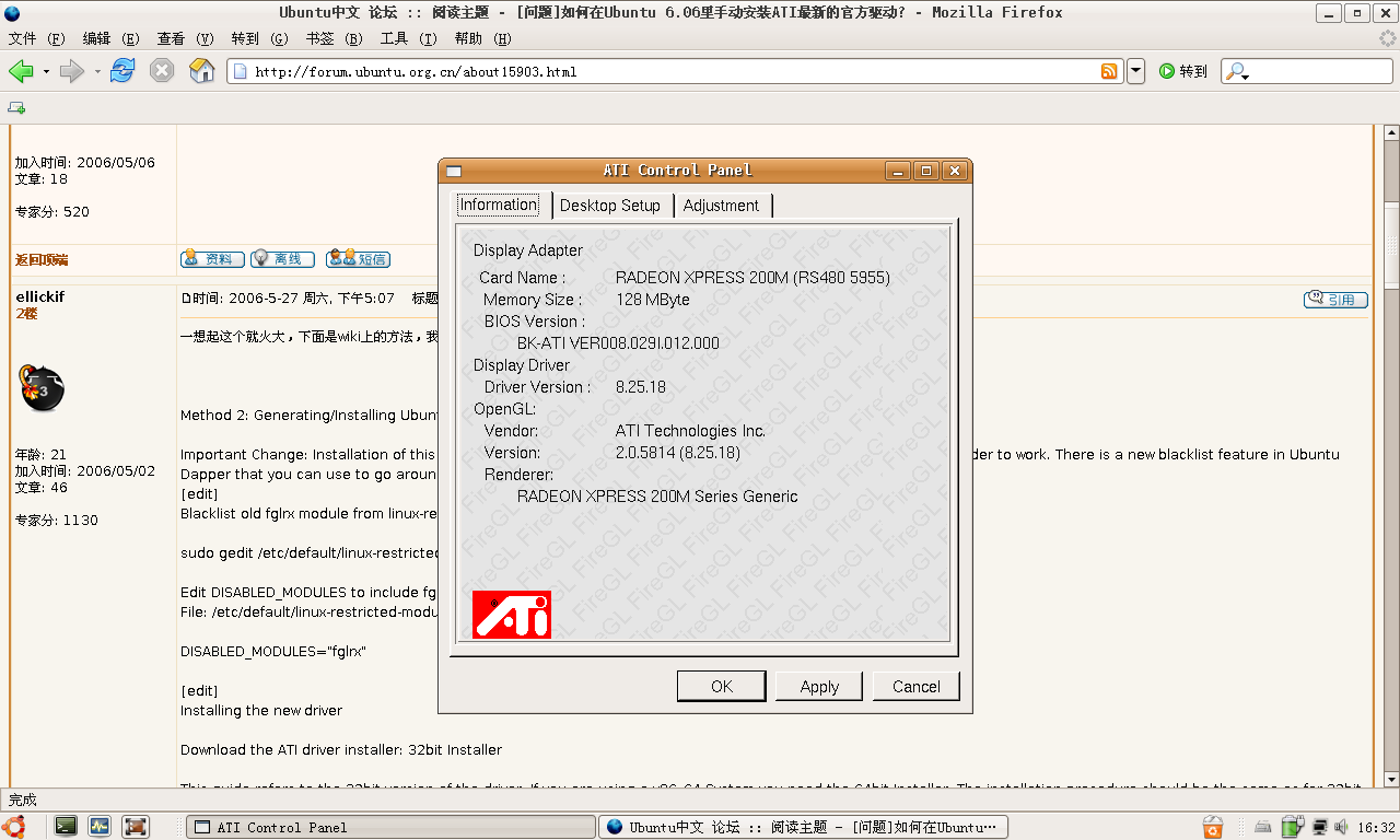

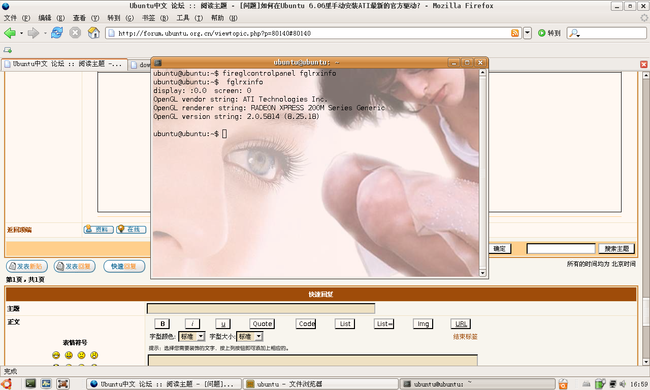

Confirm that it worked
$ fglrxinfo
display: :0.0 screen: 0
OpenGL vendor string: ATI Technologies Inc.
OpenGL renderer string: RADEON 9700 Generic
OpenGL version string: 2.0.5814 (8.25.18)

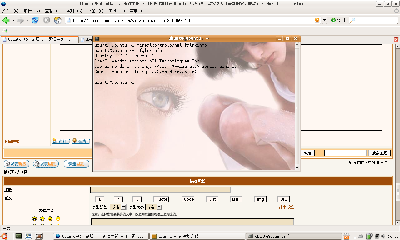

既然有人成功,那说明驱动应该没问题的。

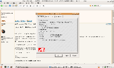

调出ATI control panel 的命令是什么?
