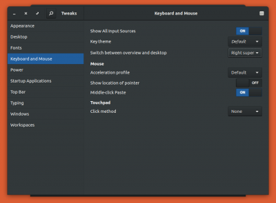

使用dconf Editor更改最大化、最小化、关闭和菜单按钮的位置
/org/gnome/settings-daemon/plugins/xsettings/overrides:
{'Gtk/ShellShowsAppMenu': <0>, 'Gtk/DecorationLayout': <'minimize,close,maximize:menu'>}
/org/gnome/desktop/wm/preferences/button-layout:
/com/solus-project/budgie-wm/button-layout:
minimize,close,maximize:appmenu

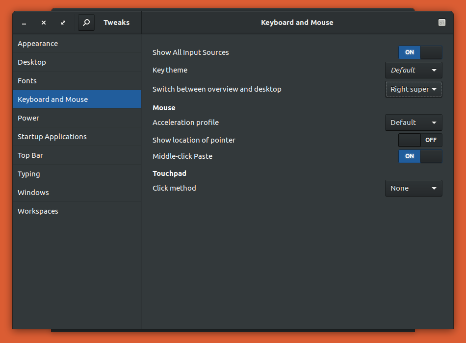

窗口最大化最小化关闭按钮左置
sudo apt-get install gnome-tweak-tool
answered Jan 5 '15
updated Jan 5 '15
Using gsettings, for example:
$ gsettings set org.gnome.desktop.wm.preferences button-layout 'minimize,maximize,close:'
That command will put Minimize, Maximize and Close buttons to the left. You can change the order and which buttons to use. (If you put : in front, buttons will be aligned to the right).
HTH,
Germán.

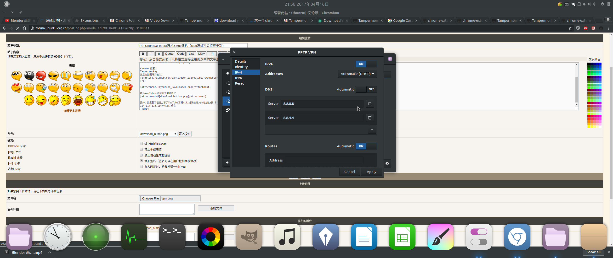

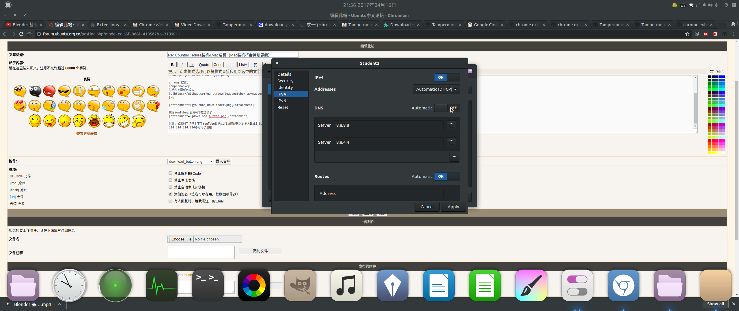

Vyprvpn设置教程
Setup the PPTP connection
Expand the connection menu by clicking the up/down arrow icon in the system taskbar. Then, click on Edit Connections to open the Network Connections control panel.
Click the Add button to add a new VPN configuration.
When prompted to choose a connection type, choose Point-to-Point Tunneling Protocol (PPTP) and click the Create button.
In the Connection name: textbox, enter "VyprVPN (PPTP)"
In the Gateway field enter one of the following server hostnames. View the list of server addresses here.
In the User name: textbox, enter your login.
In the Password: textbox, enter your password.
Click the Advanced button to bring up an additional settings dialog.
Check the Use Point-to-Point encryption (MPPE) box.
Click the OK button
Click the Save button (you may be prompted to enter your password to store the configuration securely)
Restart Network Manager (The best way we have found to restart Network Manager is to open a terminal and type "sudo restart network-manager". This will disconnect all of your network connections)
Establish a secure connection
In the system taskbar, click on the up/down arrow icon to bring up the connection menu.
Mouse over VPN Connections and select VyprVPN (PPTP).
After a few seconds, you will receive a pop-up notification that the connection has been established.
You can check your IP here:https://www.goldenfrog.com/whatismyipaddress
VyprVPN Free accounts are limited to using our Desktop and Mobile applications to connect to our VPN service. Please see "What is VyprVPN Free?" for more information.
Follow the steps below to configure OpenVPN on your Ubuntu machine. This tutorial was created using Ubuntu 16.04.1.
1. Open Terminal, which you can find by using the Ubuntu search feature.
2. Type the following command string and press Enter:
sudo apt-get install -y network-manager-openvpn network-manager-openvpn-gnome
This will install the necessary OpenVPN packages on the machine and add OpenVPN as an option in the desktop VPN configuration menu.
3. Restart network-manager by typing the following command and pressing Enter:
sudo service network-manager restart
4. Download the Golden Frog CA certificate and place it in the OpenVPN folder on your machine by typing the following command and pressing Enter. Ignore line breaks. This is one single command.
sudo wget https://support.goldenfrog.com/hc/artic ... pn.com.crt /etc/openvpn
5. Configure the OpenVPN connection by opening Network Connections. You can locate this by using the Ubuntu search feature.
6. Click Add.
7. Under VPN in the drop-down, choose OpenVPN and click Create.
8. Edit the information in the configuration screen as follows:
Connection name: VyprVPN
Gateway: Enter a server address. View a list of server addresses here.
Type: Select Password
Username: Your Golden Frog account email address
Password: Your Golden Frog account password
CA Certificate: Browse to /etc/openvpn and select ca.vyprvpn.com.crt
9. Click Advanced.
10. Check the option for Use LZO data compression and click OK.
11. Click Save.
How to Connect and Disconnect:
1. Click the Network Connections icon at the top of your desktop in right area of the menu bar. It will generally look like two arrows opposite each other or a WiFi signal.
2. Scroll down to VPN Connections.
3. Click VyprVPN and wait for the connection to establish.
4. You will see a pop-up once connected. Additionally, a lock icon will appear by your network icon in the top menu bar.
5. To disconnect any any time, navigate back to the Network Connections drop-down in the top menu bar, click VPN Connections, and then click Disconnect VPN.
6. Enjoy VyprVPN on your Ubuntu machine!

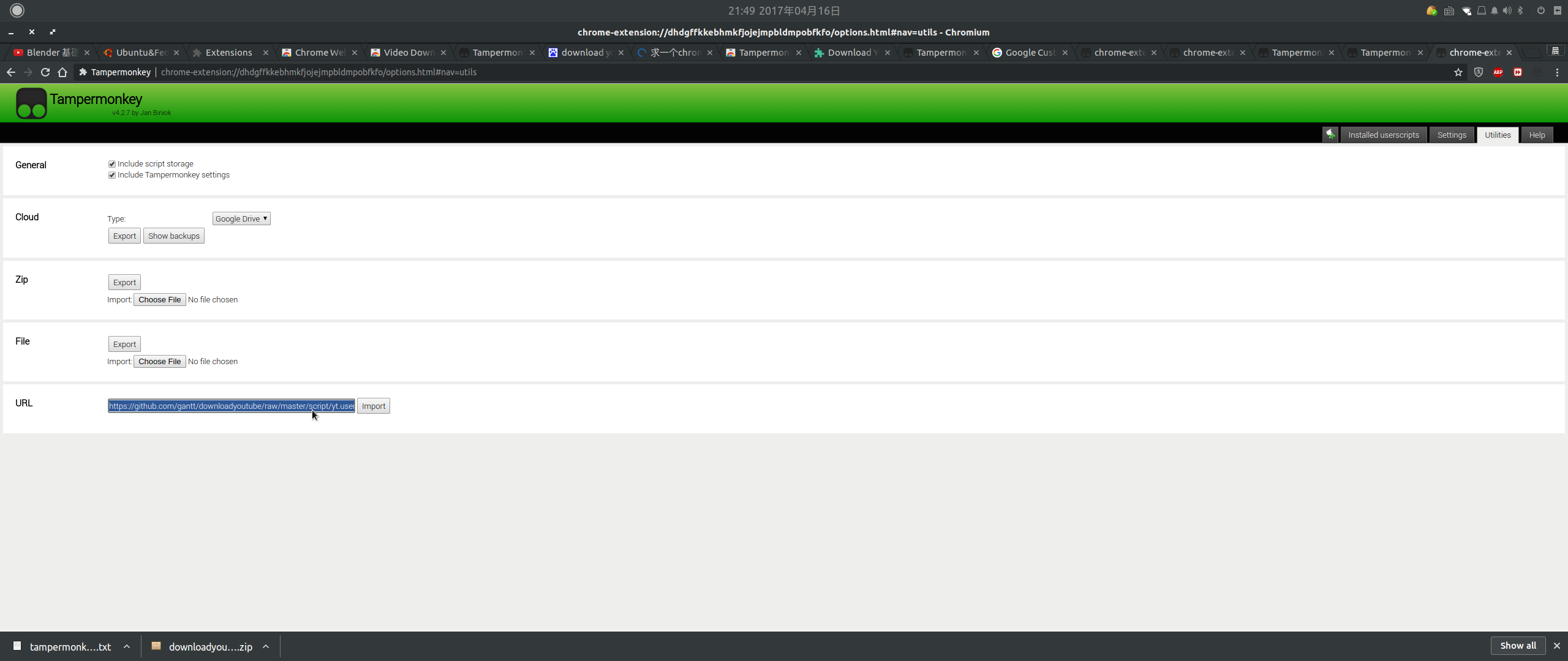

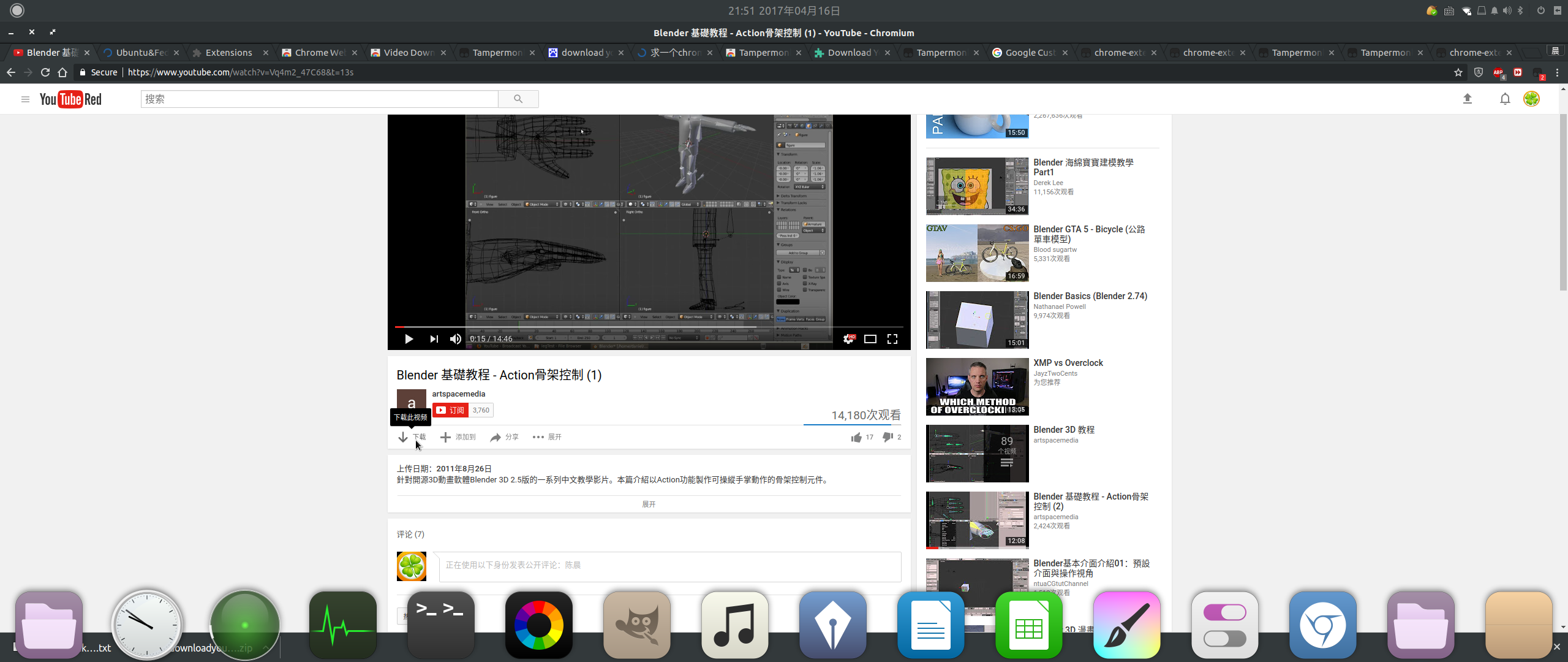

chrome 搜索:
Tampermonkey
然后在如图所示输入:
https://github.com/gantt/downloadyoutub ... yt.user.js
然后YouTube页面就有下载选项了 另外:如果翻了墙还上不了YouTube请把wifi或网线输入的地方改成8.8.8.8;8.8.4.4不是VPN的ip4 DNS

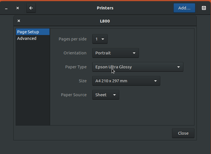

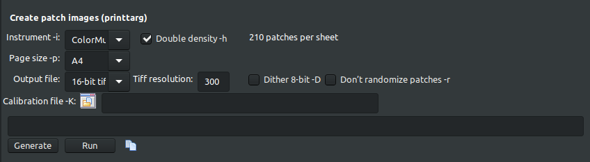

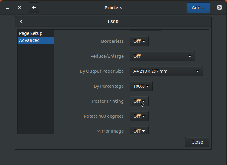

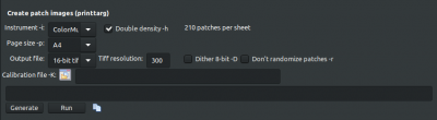

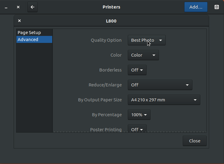

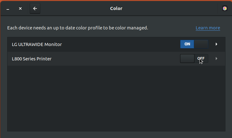

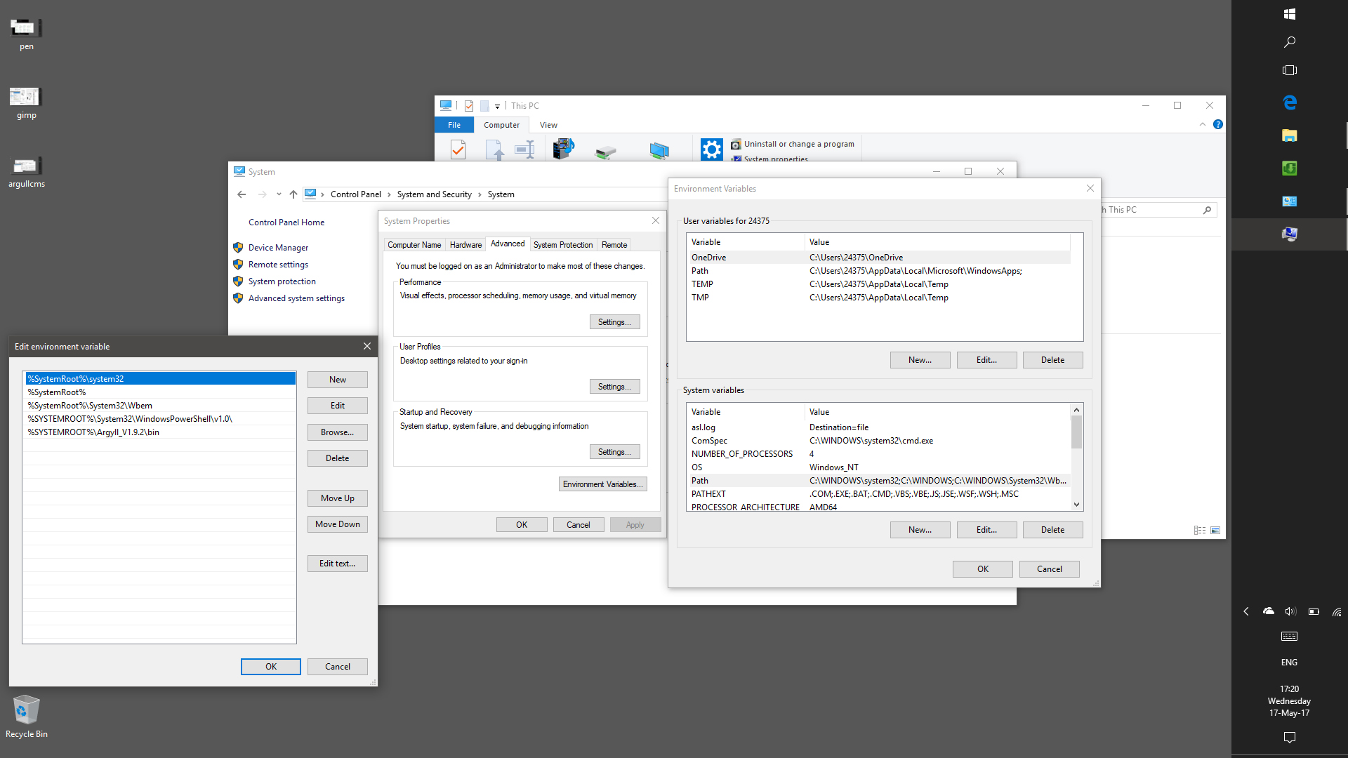

linux上的打印机校色教程:
从http://www.russellcottrell.com/photo/LittleArg ... eargyllgui
The -e parameter sets the number of white colored test patches, defaulting to 4 if the -e flag isn't used. The white patches are usually very important in establishing white point that the ICC data is made relative to, so it improves robustness to use more than a single point.
The -B parameter sets the number of black colored test patches, defaulting to 4 if the -B flag isn't used and the colorspace is grey or RGB. The black point can be very important for characterizing additive color spaces, so measuring more than one black patch improves robustness over measuring just a single point.
The -g parameter sets the number of patches in a set of combined (nominally gray) wedges. This will typically be equal RGB or CMY values, and by default will be equally spaced steps in device space. If the -p parameter is provided, then, then the steps will be distributed according to the power value. e.g. the option -g 5 will generate steps at 0.0 0.25 0.5 0.75 and 1.0, while the option -g 5 -p 2.0 will generate steps at 0.0 0.0625 0.25 0.5625 and 1.0. By default, no gray combination values are generated. When creating a test chart for a device that will be used as a source colorspace, it is often useful to generated some per colorant wedge values.
The -f parameter sets the number of full spread test patches.
设置好后
点击Generate然后点run
然后
instrument选colorMunki
Page:A4
output:16bit
resolution:300
点击Generate然后点run 然后chartread处直接点generate 然后点run不用设置

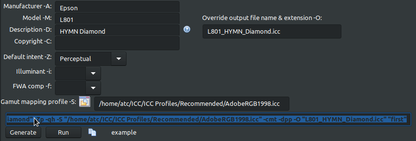

Manufacture:打印机生产商
Model:打印机型号
Description:相纸类型
-O:文件名.icc
-S:选择AdobeRGB1998(因为不让上传所以请自己从Photoshop的目录里拷)
-Z:Perceptual
其他不设置,
如果-i 和 -f在Generate 生成的命令里出现了那么删除它之后点run就可以了 argyllcms自带错误识别所以不用担心扫错了,但是有个小提示:听到水滴声请将设备置于最前面的白色部分(那个也是要扫描的色块尽管是白色)然后压住按钮匀速扫过去,可以扫的很快,扫错了按“回车”然后按“b”重新扫,全部扫完按d结束,注意:不要点patch by patch!

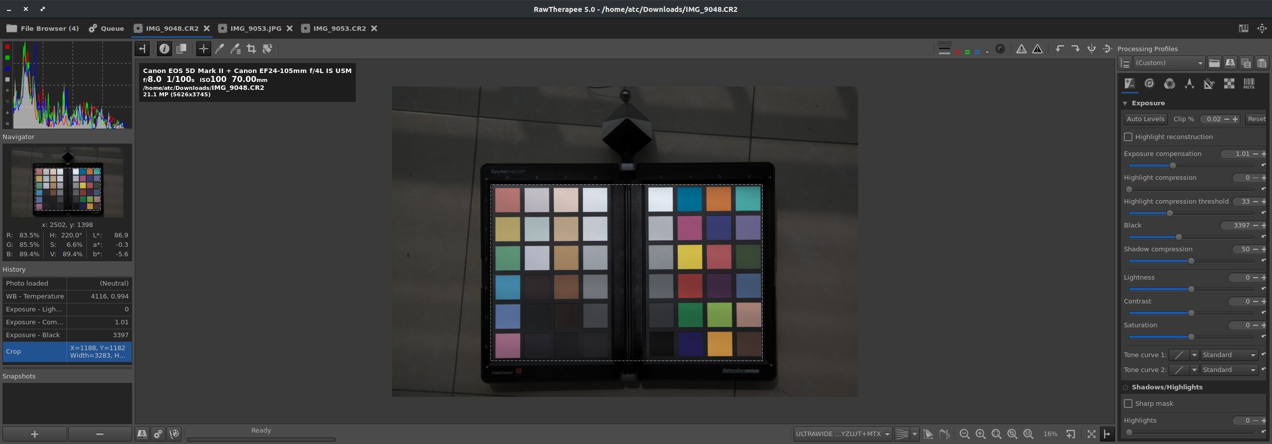

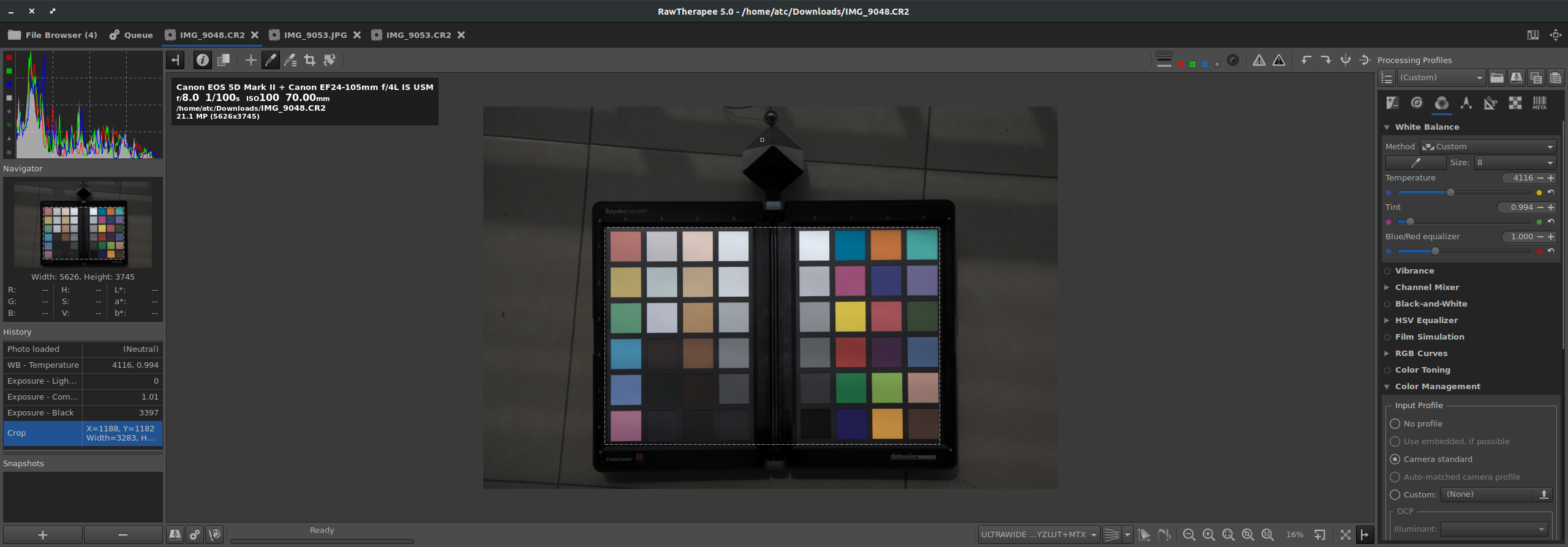

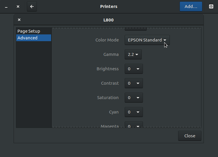

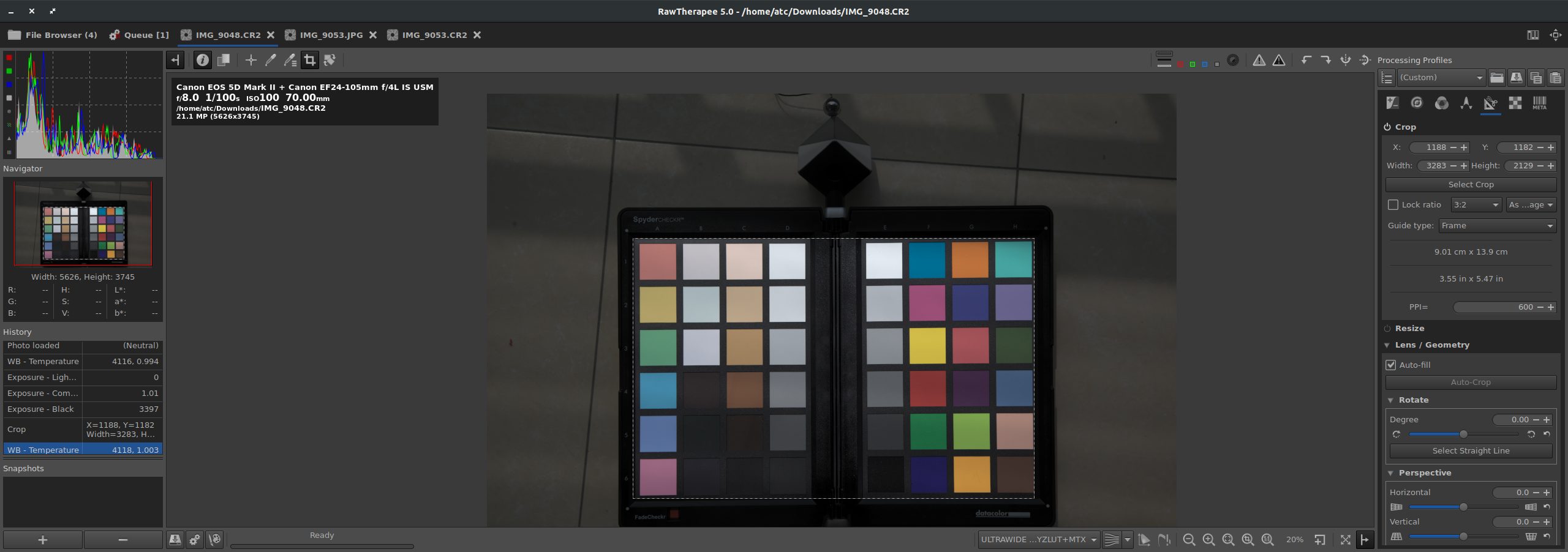

另外请对打印机设置平直打印,最高质量打印,纸张选择极度高光,关闭快速打印,在打印色表的时候关闭打印机的色彩管理(不是显示器或禁用全部色彩管理) 对spyder checkr(48色)进行拍摄,
然后把点击铬球受光面的SpyderCube的灰面(设置白平衡) 然后调整曝光(exposure)使白色达到RGB90%(左侧有显示) 然后拖动Black将黑色达到4%以下(左侧有显示) 选择netral(裁剪后变为custom),也可以对其进行稍微旋转(按钮在裁剪图标的右边) 然后点左下角的齿轮,然后选择16位TIFF其他默认 scanin -v -p -dipn IMG_9047.tif SpyderChecker.cht SpyderChecker.cie
p will show the sampling areas as colored pixels.

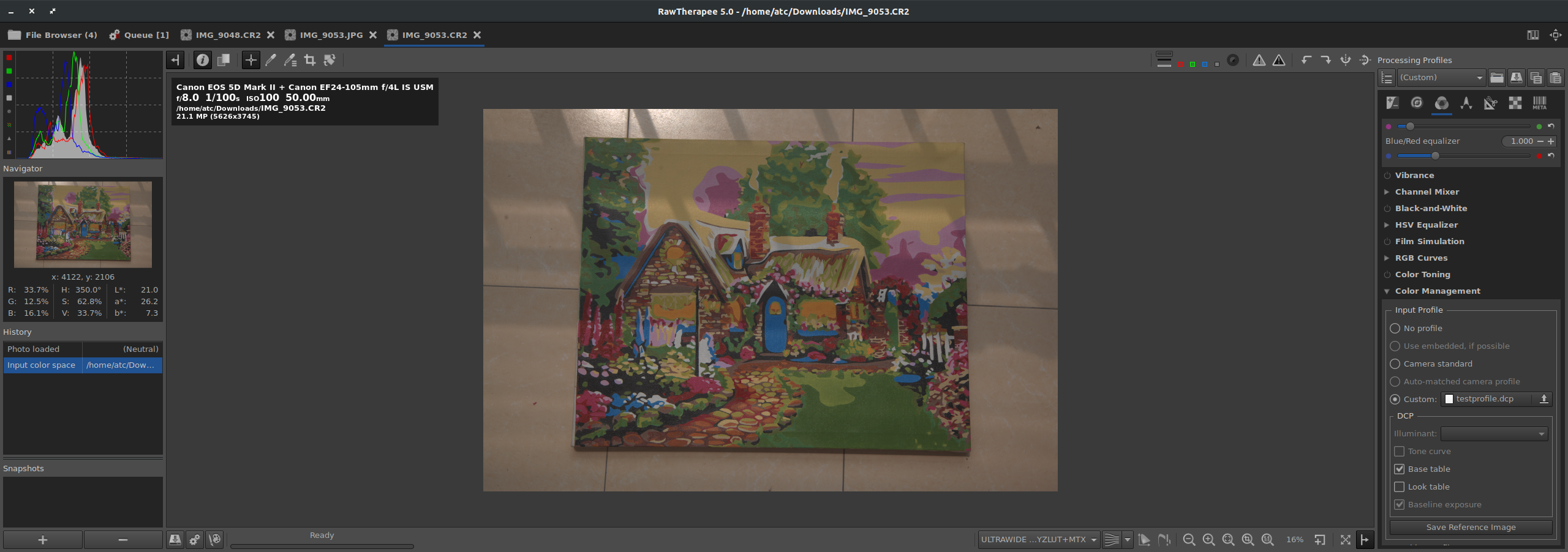

dcamprof make-dcp -c "Canon EOS 5D Mark II" profile.json testprofile.dcp
然后于Color选项的color management的input profile中选择custom加载即可。

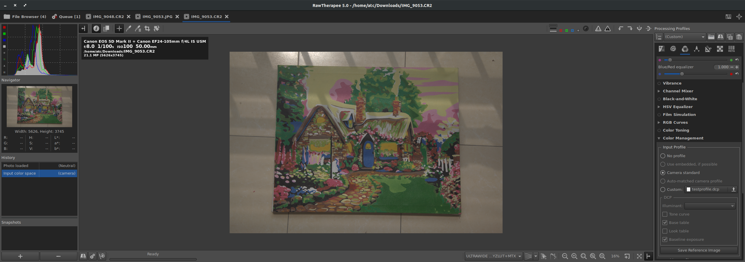

未应用DCP配置文件: 应用之后(颜色和色温改善很多):

KT-Laptop-3:Debug kirkt$ dcamprof make-profile target.ti3 profile.json
Reading target and generating values for the calibration illuminant D50...
Re-generating target reference XYZ values for illuminant D50...
Making camera profile...
Finding a camera raw RGB to CIE XYZ matrix for illuminant D50...
Whitest patch in target differs DE 1.18 from calibration illuminant,
close enough to calculate whitepoint preservation.
Inverting to get ColorMatrix:
"ColorMatrix1": [
[ 0.729155, -0.155578, -0.066452 ],
[ -0.482378, 1.364639, 0.172933 ],
[ -0.111882, 0.237018, 0.685179 ]
Matrix patch match average DE 1.38, DE LCh 0.61 0.63 0.97
mean DE 1.24, DE LCh 0.50 0.51 0.69
p90 DE 2.32, DE LCh 1.28 1.15 1.90
max DE 4.06, DE LCh 1.92 1.90 3.94
ColorMatrix optimal white balance for target: 0.478142,1,0.660402
Using previously calculated RGB to XYZ D50 matrix.
Applying white-balance to get ForwardMatrix:
"ForwardMatrix1": [
[ 0.738497, 0.156947, 0.072765 ],
[ 0.257033, 0.850257, -0.107290 ],
[ 0.031675, -0.268494, 1.049609 ]
Matrix patch match average DE 1.58, DE LCh 0.96 0.59 0.98
mean DE 1.48, DE LCh 0.91 0.60 0.69
p90 DE 2.58, DE LCh 1.83 1.05 1.91
max DE 4.23, DE LCh 2.40 1.78 3.95
ForwardMatrix optimal white balance for target: 0.478142,1,0.660402
Making 2.5D chromaticity-addressed lookup table for XYZ correction...
25.00% of the patches was put in a chromaticity group due to nearby neighbor.
Largest chromaticity group contains 6 patches. Patch count reduced from
24 to 18. Note that patch matching cannot reach 100% when chromaticity
groups are formed, as the LUT matches the average within a group.
Native LUT patch match average DE 0.37, DE LCh 0.14 0.15 0.23
mean DE 0.00, DE LCh 0.00 0.00 0.00
p90 DE 1.21, DE LCh 0.48 0.60 0.81
max DE 1.89, DE LCh 1.19 0.95 1.80
5 worst patches for Overall DE:
0 RGB 0.077 0.106 0.054 => XYZ 0.127 0.111 0.055 (0.130 0.114 0.054) DE 1.89 DE LCh 0.57 0.04 1.80 (dark brown)
18 RGB 0.484 1.000 0.652 => XYZ 0.965 1.000 0.779 (0.948 0.978 0.773) DE 1.40 DE LCh 0.48 0.95 0.90 (white)
23 RGB 0.019 0.041 0.027 => XYZ 0.034 0.035 0.029 (0.039 0.040 0.033) DE 1.21 DE LCh 1.19 0.23 0.05 (gray 20%)
20 RGB 0.194 0.408 0.267 => XYZ 0.380 0.394 0.320 (0.382 0.398 0.318) DE 1.02 DE LCh 0.19 0.89 0.46 (gray 70%)
22 RGB 0.048 0.103 0.068 => XYZ 0.094 0.098 0.081 (0.096 0.101 0.082) DE 1.02 DE LCh 0.42 0.60 0.71 (gray 40%)
5 worst patches for Lightness DE:
19 RGB 0.319 0.671 0.440 => XYZ 0.622 0.645 0.521 (0.628 0.654 0.525) DE 0.64 DE LCh 0.28 0.58 0.03 (gray 80%)
5 worst patches for Chroma DE:
21 RGB 0.102 0.215 0.141 => XYZ 0.202 0.210 0.171 (0.202 0.210 0.168) DE 0.78 DE LCh 0.06 0.32 0.71 (gray 50%)
5 worst patches for Hue DE:
1 RGB 0.253 0.363 0.201 => XYZ 0.424 0.382 0.204 (0.422 0.378 0.206) DE 0.84 DE LCh 0.22 0.03 0.81 (red)
5 best patches for Overall DE:
16 RGB 0.187 0.186 0.183 => XYZ 0.325 0.223 0.259 (0.325 0.223 0.259) DE 0.00 DE LCh 0.00 0.00 0.00 (purple-red)
3 RGB 0.071 0.154 0.065 => XYZ 0.123 0.141 0.056 (0.123 0.141 0.056) DE 0.00 DE LCh 0.00 0.00 0.00 (yellow-green)
2 RGB 0.089 0.249 0.219 => XYZ 0.189 0.211 0.284 (0.189 0.211 0.284) DE 0.00 DE LCh 0.00 0.00 0.00 (purple-blue)
14 RGB 0.152 0.093 0.045 => XYZ 0.224 0.134 0.041 (0.224 0.134 0.041) DE 0.00 DE LCh 0.00 0.00 0.00 (red)
9 RGB 0.048 0.078 0.084 => XYZ 0.090 0.073 0.117 (0.090 0.073 0.117) DE 0.00 DE LCh 0.00 0.00 0.00 (dark purple)
Writing output to "profile.json"...
Complete!

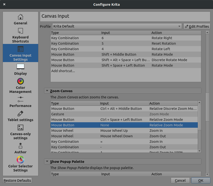

对krita和gnome-tweak-tool进行相关设置,以防止快捷键冲突
打开Control Panel -> System and Security -> System -> Advanced system settings -> Environment Variables -> System varriables -> Path -> 添加
%SYSTEMROOT%\Argyll_V1.9.2\bin 然后设置Control Panel -> Pen and touch -> Press and hold -> 取消勾选 注意:此处使用的是boogie board sync 需要安装Sync VDC 并开启digitizer模式(比wacom好用)

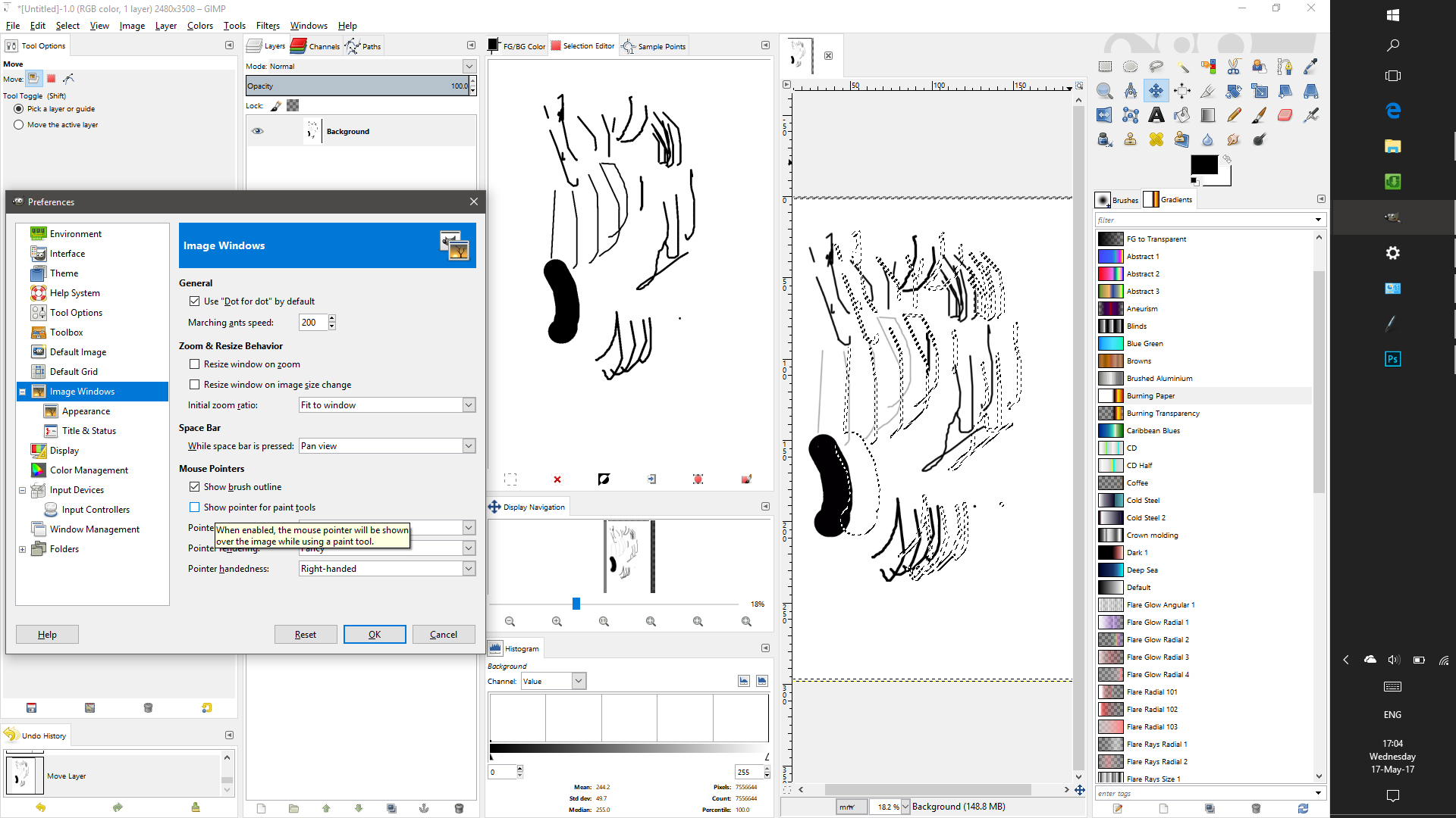

然后对gimp进行设置使其不显示鼠标图标:Edit -> Preference -> Image Window -> Show pointer for paint tools ->取消勾选 windows10上可以装

另外一点在DisplayCal 校色时请把Display下的自动亮度给关闭以维持一个固定值另外Night light也要关闭

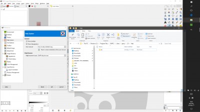

Gimp填充快捷键冲突解决办法

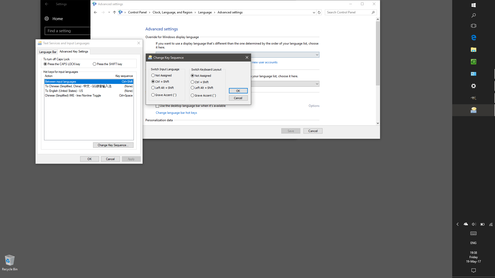

安装QQ 拼音,卸载搜狗输入法 (因为搜狗输入法自身设置与gimp快捷键冲突但却无法修改 所以请卸载)
然后在Control Panel -> Clock Language and Region -> Language -> Advanced Settings -> Change language bar hot keys -> Advanced Key Settings -> Between input languages -> Switch Input Language 设置为Ctrl+Shift && Switch Keyboard Layout 设置为Not Assigned 从官方下载help的exe安装包后如果是GB(Globle版)需要将
C:\Program Files\GIMP 2\share\gimp\2.0\help文件夹下的en-GB改为en即可然后在
gimp的
Edit -> Preference -> Help System -> General -> User Manual设置为 Use a locally installed copy即可
win10 上的色彩管理请按照如图所示输入打开Control Panel -> System and Security -> System -> Advanced system settings -> Environment Variables -> System varriables -> Path -> 添加
