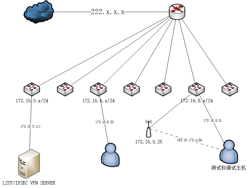

调试了一周的L2TP/IPSEC VPN ,还是没有搞定,贴出来大家一起看一下吧!
帖子 micro_cy » 2017-06-13 16:18
先上传1张图谱结构图,以便大家能了解我目前的网络结构。
根据网上各种文档的教程,先安装相关的程序,我自己的系统环境现在Ubuntu 14.04.5,后来同意更改成官方的教程了,不过还是没有连上。

Jun 13 15:42:28 xxxsq-server pluto[32486]: "L2TP-PSK-NAT"[3] 172.16.8.31 #3: sending notification PAYLOAD_MALFORMED to 172.16.8.31:500
Jun 13 15:42:32 xxxsq-server sudo: xxxsq : TTY=pts/22 ; PWD=/home/xxxsq ; USER=root ; COMMAND=/bin/su
Jun 13 15:42:32 xxxsq-server sudo: pam_unix(sudo:session): session opened for user root by xxxsq(uid=0)
Jun 13 15:42:32 xxxsq-server su[32704]: Successful su for root by root
Jun 13 15:42:32 xxxsq-server su[32704]: + /dev/pts/22 root:root
Jun 13 15:42:32 xxxsq-server su[32704]: pam_unix(su:session): session opened for user root by xxxsq(uid=0)
Jun 13 15:42:43 xxxsq-server pluto[32486]: "L2TP-PSK-NAT"[3] 172.16.8.31 #3: next payload type of ISAKMP Identification Payload has an unknown value: 247
Jun 13 15:42:43 xxxsq-server pluto[32486]: "L2TP-PSK-NAT"[3] 172.16.8.31 #3: probable authentication failure (mismatch of preshared secrets?): malformed payload in packet
Jun 13 15:42:43 xxxsq-server pluto[32486]: | payload malformed after IV
Jun 13 15:42:43 xxxsq-server pluto[32486]: | c7 f0 6b 30 3b 5a 4f 72 6a 51 a1 87 8c 06 c7 93
Jun 13 15:42:43 xxxsq-server pluto[32486]: | b5 af 13 5e
Jun 13 15:42:43 xxxsq-server pluto[32486]: "L2TP-PSK-NAT"[3] 172.16.8.31 #3: sending notification PAYLOAD_MALFORMED to 172.16.8.31:500
Jun 13 15:43:11 xxxsq-server pluto[32486]: "L2TP-PSK-NAT"[3] 172.16.8.31 #3: max number of retransmissions (2) reached STATE_MAIN_R2
Jun 13 15:43:11 xxxsq-server pluto[32486]: "L2TP-PSK-NAT"[3] 172.16.8.31: deleting connection "L2TP-PSK-NAT" instance with peer 172.16.8.31 {isakmp=#0/ipsec=#0}

astolia
帖子: 6703
注册时间: 2008-09-18 13:11
Re: 调试了一周的L2TP/IPSEC VPN ,还是没有搞定,贴出来大家一起看一下吧!
帖子 astolia » 2017-06-14 11:04
我还是第一次看到有人把ip范围写成10.11.17.111-172.11.17.222这样把共有和私有地址混在一起的。
另外L2TP/IPSEC早就被gfw攻破了,如果你是要靠这个来翻墙的话,趁早放弃。
micro_cy
帖子: 104
注册时间: 2011-07-20 11:33
帖子 micro_cy » 2017-06-15 8:17
astolia 写了:我还是第一次看到有人把ip范围写成10.11.17.111-172.11.17.222这样把共有和私有地址混在一起的。
这个地址是手误,应该是10.11.17.111-10.11.17.222.
这个VPN不是用来翻墙的,这个VPN是架设在单位,目的是出差的时候可以访问到内网的多个服务器。
已经测试成功,原因还是UDP和TCP的方式选择问题。
