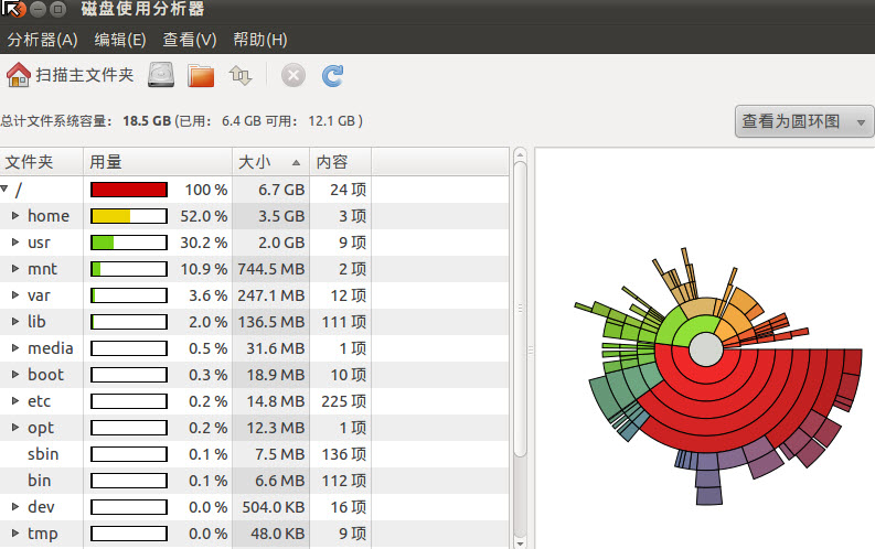

各位大侠好:
在virtualbox安装ubuntu,分给20G的空间,但是在主文件夹装了一些软件、程序之后,发现空间不足的问题:
磁盘使用分析器扫描的结果是,总计文件系统容量18.5GB(已用6.4GB;可用12.1GB)
安装了软件、程序的根目录“/”空间已满,怎样利用可用空间的12.1GB呢?谢谢了!

谢谢!是下面这个信息么?sunfish 写了:20G你怎么分区的,把分区给出来啊,不然怎么看
Disk /dev/sda: 22.2 GB, 22161653760 bytes
255 heads, 63 sectors/track, 2694 cylinders
Units = cylinders of 16065 * 512 = 8225280 bytes
Sector size (logical/physical): 512 bytes / 512 bytes
I/O size (minimum/optimal): 512 bytes / 512 bytes
Disk identifier: 0x000e1e75
Device Boot Start End Blocks Id System
/dev/sda1 * 1 608 4881408 83 Linux
Partition 1 does not end on cylinder boundary.
/dev/sda2 608 2695 16757761 5 Extended
/dev/sda5 608 730 975872 83 Linux
/dev/sda6 730 1216 3905536 83 Linux
/dev/sda7 1216 1459 1951744 82 Linux swap / Solaris
/dev/sda8 1460 2695 9921536 83 Linux

看不出那12.1G分到哪了,说一下安装时分了哪几个区,容量各是多少
把 /etc/fstab 内容贴一下

你打开Terminal
在里面的提示符后面输入:
$df -h
把结果贴出来吧,系统文件那个只给出了各文件夹信息,没有分区信息
在里面的提示符后面输入:
$df -h

谢谢!文件全部内容见下述:TeliuTe 写了:看不出那12.1G分到哪了,说一下安装时分了哪几个区,容量各是多少
把 /etc/fstab 内容贴一下
# /etc/fstab: static file system information.
# Use 'blkid -o value -s UUID' to print the universally unique identifier
# for a device; this may be used with UUID= as a more robust way to name
# devices that works even if disks are added and removed. See fstab(5).
# <file system> <mount point> <type> <options> <dump> <pass>
proc /proc proc nodev,noexec,nosuid 0 0
# / was on /dev/sda1 during installation
UUID=47c89e94-110e-46c5-abe7-1b9205e6fe86 / ext4 errors=remount-ro 0 1
# /boot was on /dev/sda5 during installation
UUID=dbca5926-ae50-45b8-ade8-e8127c0cb0c7 /boot ext3 defaults 0 2
# /home was on /dev/sda6 during installation
UUID=00103934-5b92-47a7-8099-f7b24c555902 /home ext2 defaults 0 2
# /usr/local was on /dev/sda8 during installation
UUID=9294121b-e196-44e7-bb80-d4d75dcf9bdd /usr/local ext4 defaults 0 2
# swap was on /dev/sda7 during installation
UUID=31a91d84-cdfb-4139-a1ff-61d19021220c none swap sw 0 0

分区信息如下:sunfish 写了:你打开Terminal
在里面的提示符后面输入:
$df -h
文件系统 容量 已用 可用 已用%% 挂载点
/dev/sda1 4.6G 2.7G 1.8G 61% /
none 243M 224K 243M 1% /dev
none 249M 136K 249M 1% /dev/shm
none 249M 312K 248M 1% /var/run
none 249M 0 249M 0% /var/lock
/dev/sda5 938M 37M 855M 5% /boot
/dev/sda8 9.4G 150M 8.7G 2% /usr/local
/dev/sda6 3.7G 2.8G 784M 79% /home
/dev/sr0 32M 32M 0 100% /media/VBOXADDITIONS_3.2.6_63112
谢谢!
- 帖子: 7
- 注册时间: 2011-12-08 17:11
Re: virtualbox 安装ubuntu,主文件夹空间不足怎么办?
现在不能更新系统及程序数据包,一更新就会提示没有空间,不知道该如何利用/usr/local的空间了~我是初学者,当初不知道没有必要分这么多区...谢谢大家!

比较直观应该看“磁盘使用工具”或者“Gpartd” 容易知道你的剩余空间在哪 你那主分区后面如果直接接扩展分区的话就没戏了,不如格了重装算了 装的时候选“清空并使用整个磁盘” 或者手动全部划给 / 我感觉swap没什么必要(只要内存给的不是太少又不休眠) boot也没什么必要 /home自行考虑

呵呵,你虚拟机里还分这么多区。
你把这个9.4G分给/usr/local当然用不完了。要不把这个分区删了吧,记得删完要改/etc/fstab。

删了之后是不是能转移给/ 目录?怎么删除啊?怎么手动改ect/fstab呢?谢谢!cwll 写了:呵呵,你虚拟机里还分这么多区。
