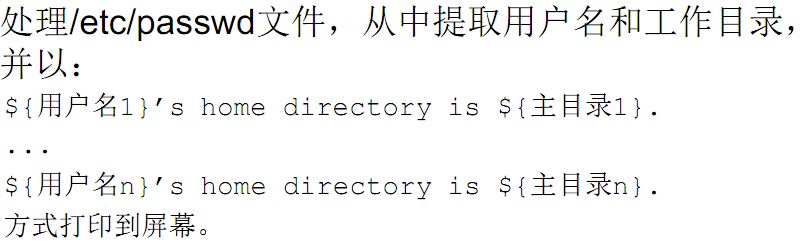

请教一个题目
帖子 linbocn » 2010-12-11 13:07
谢谢各位。搞好了

sed "s#\(^[^:]*\)[^/]*\(/.*\)#\1\ 's home is \2 #" /etc/passwd

#! /usr/bin/perl
open(PASSWD , "/etc/passwd");
chomp(@pws = <PASSWD>);
for (@pws) {
  @line = split /:[^\/]+/;
  print "$line[0] 's home is $line[1]\n";

如果没有中间的“'s home is”,cut也行
cut -f 1,6- -d":" /etc/passwd

帖子 linbocn » 2010-12-11 21:40
trigger 写了:
#! /usr/bin/perl
for (@pws) {
报错了 syntax error near unexpected token `PASSWD'

你是怎么执行的?

帖子 linbocn » 2010-12-12 12:57
可以了。谢谢

[bash]
awk -F : '{ print $1 "'\''s home directory is " $6 }' /etc/passwd
[/bash]
这个表达有意思,学习了:)

#!/bin/bash
FILE="/etc/passwd"
while read line; do
    [ "$line" == "::::::" ] && continue
    echo $line | cut -d":" -f1,6 | \
        sed -n -e "s/\(.*\):\(.*\)/\1's home directory is \2./p"
done < $FILE

#!/usr/bin/expect --
log_user 0
set f [open /etc/passwd]
spawn -noecho -open $f
expect {
    -re {([^:]*):[^:]*:[^:]*:[^:]*:[^:]*:([^:]*)[^\n]*\n} {
        puts "$expect_out(1,string)'s home is $expect_out(2,string)"
        exp_continue
    eof
wait
