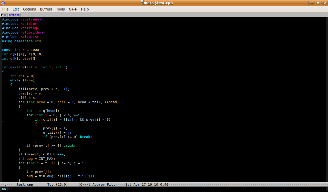

另外一个问题是 C++ mode 下似乎不能正确识别变量名称,具体情况看以下截图:
for (int i = 0; i < n; ++i)
中,只有第一个 i 被标上了颜色,其他地方也是类似的,
只有在紧跟这类型名称后面的变量才有颜色。
我的意思要不它索性所有变量一律不标颜色,象这样不统一的颜色很难看。。。
我用的是 color-theme 是 midnight,根据我的实验,这个颜色问题与什么 color-theme 没有关系。

1. I confront with the same problem that Emacs determine how to indent after I type, my solution is ignore the problem :)
2. It's about face for font lock (you can find more in info elisp)
In my Emacs 23.1, neither first i nor other i change face (their have the default black font color)

The second problem has an explanation from Emacs mailing list.
That's correct fontification; the first i is fontified because it is
being declared, the other appearances being mere use of the variable.
cuiaoxiang
帖子: 62
注册时间: 2010-02-01 19:08
Re: 用 Emacs 写 C++ 代码的几个问题
帖子 cuiaoxiang » 2010-04-28 0:40
davyzhu 写了:The second problem has an explanation from Emacs mailing list.
恩,好的。有个地方看的不舒服的就是为什么 着色不像很多 编辑器那样把 阿拉伯数字也着色呢?还是可以有参数调整出来的?
