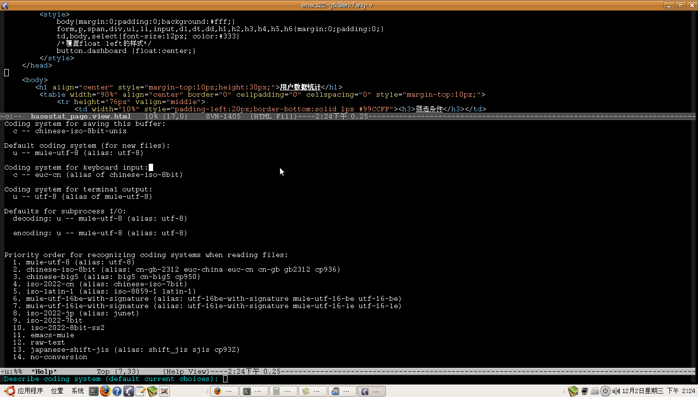

谢谢楼上,unicad.el的确是好东西,我刚才试用了一下,现在打开文件编码是没有问题了,可以正确显示!
然而,我这时执行
M-X describe-coding-system时,得到下面的输出:
##输出开始---------
Coding system for saving this buffer:
c -- chinese-iso-8bit-unix
Default coding system (for new files):
u -- mule-utf-8 (alias: utf-8)
Coding system for keyboard input:
c -- euc-cn (alias of chinese-iso-8bit)
Coding system for terminal output:
u -- utf-8 (alias of mule-utf-8)
Defaults for subprocess I/O:
decoding: u -- mule-utf-8 (alias: utf-8)
encoding: u -- mule-utf-8 (alias: utf-8)

问题在于
所以一旦修改文件并保存就把文件的编码变为utf-8了,所以要找到比较好的方法能自适应文件编码,比如是gb2312的,这个地方的encoding也是gb2312就好了
