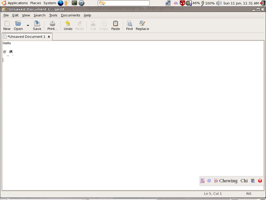

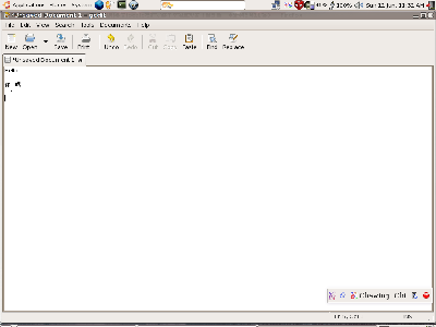

In certain applications, such as GAIM and Gnome Text Editor, certain Chinese characters are blank when I type them in. (I use SCIM and Chewing) They display properly in other applications such as Firefox and OpenOffice.

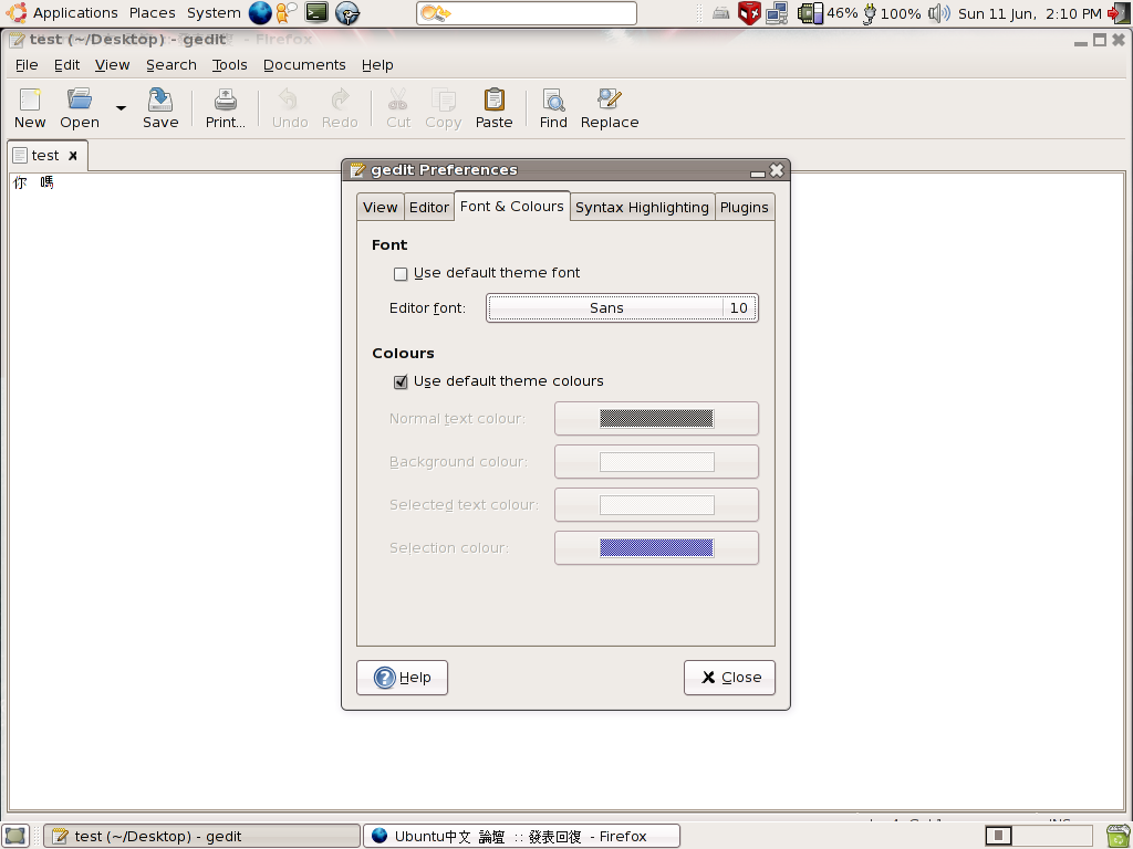

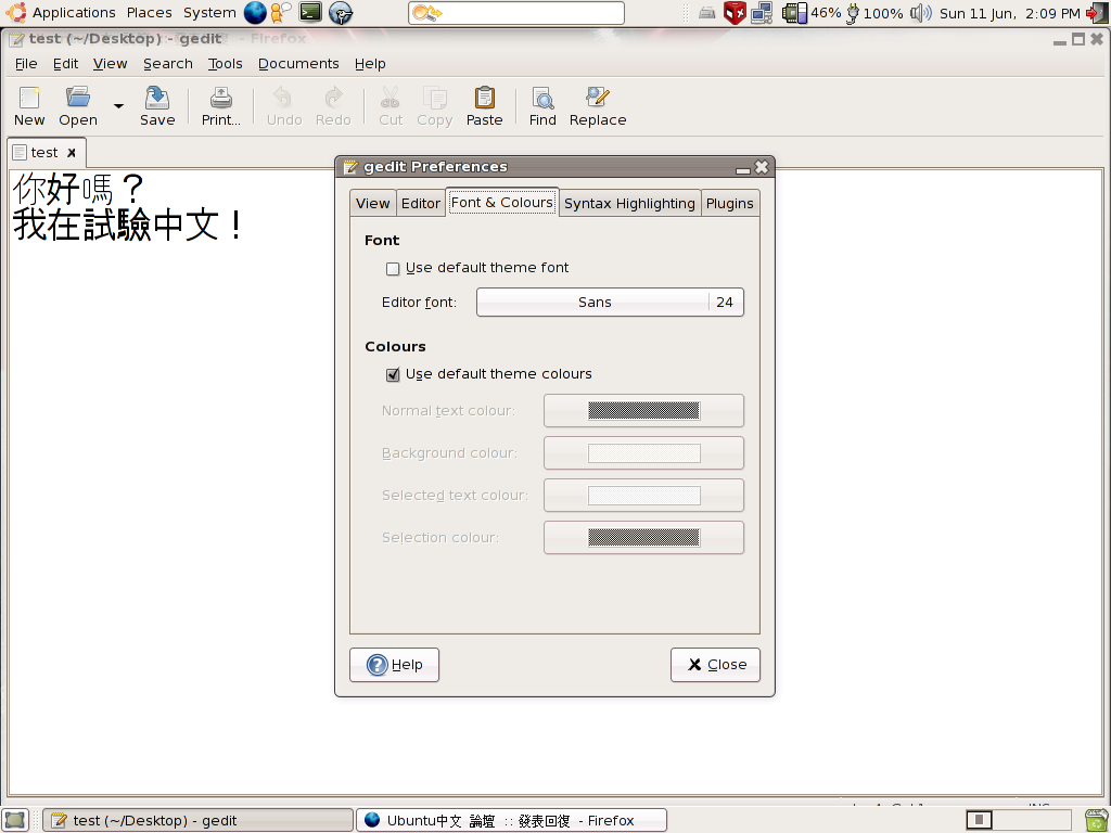

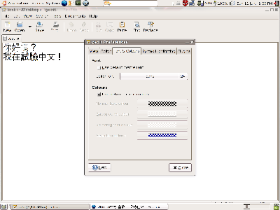

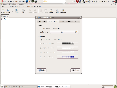

I discovered the problem. In my English locale, I am using Sans font @ size 10. This makes some words disappear. When I make this bigger, the words are back. So, something is wrong with the font scaling in these applications (only GAIM and Gedit, so far).
I've posted the screenshots. Any suggestions?
