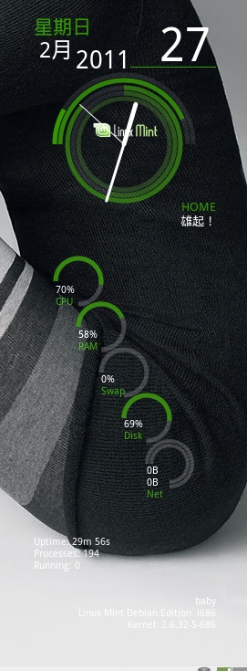

系统U10.10,conky为源里的all,具体修改自:
viewtopic.php?f=12&t=280236
菜鸟打酱油修改。。娱乐。。

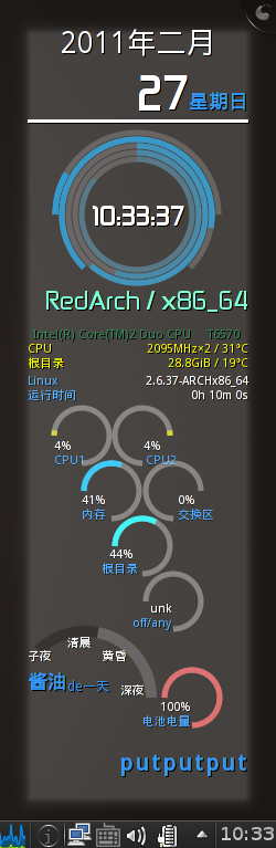

主要修改:
1. 给圈圈绘制提供了顺时针和逆时针两种,图中CPU1为顺时针,CPU2为逆时针;交换区也是逆时针(本人无SWAP。。)
具体代码(看起始转角和最终转角的大小关系判断顺时针与否):
if angle_0>angle_f then
cairo_arc_negative(cr,xc,yc,ring_r,angle_0,angle_f)
else
cairo_arc(cr,xc,yc,ring_r,angle_0,angle_f)
end

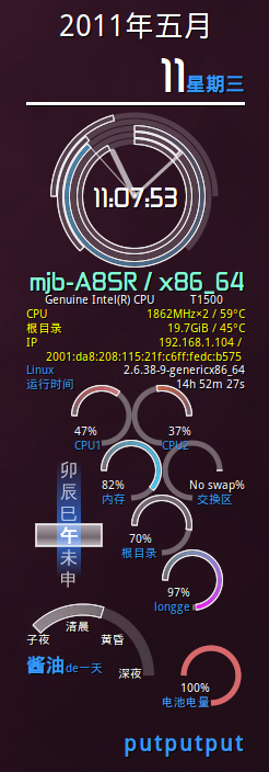

3. 为绘制的弧线进度条提供渐变(含透明度,颜色等)效果,具体settings_table内容修改如下:
name='time',
arg='%I.%M',
max=12,
-- "bg_colour" is the colour of the base ring.
bg_colour=0xffffff,
-- "bg_alpha" is the alpha value of the base ring.
bg_alpha=0.1,
-- "fg_colour" is the colour of the indicator part of the ring.
fg_colour=0x3399cc,
-- "fg_alpha" is the alpha value of the indicator part of the ring.
fg_alpha=0.2,
--自己修改的进度条:0 不开启;1 仅开启进度条变色;2 仅开启透明度变化;3 开启1、2;4 仅开启边框;5 仅开启颜色透明度过渡;6 开启4、5;
change_color=4,
start_alpha=0.2,
end_alpha=0.2,
startcolor=0x3399cc,
endcolor=0x3399cc,
