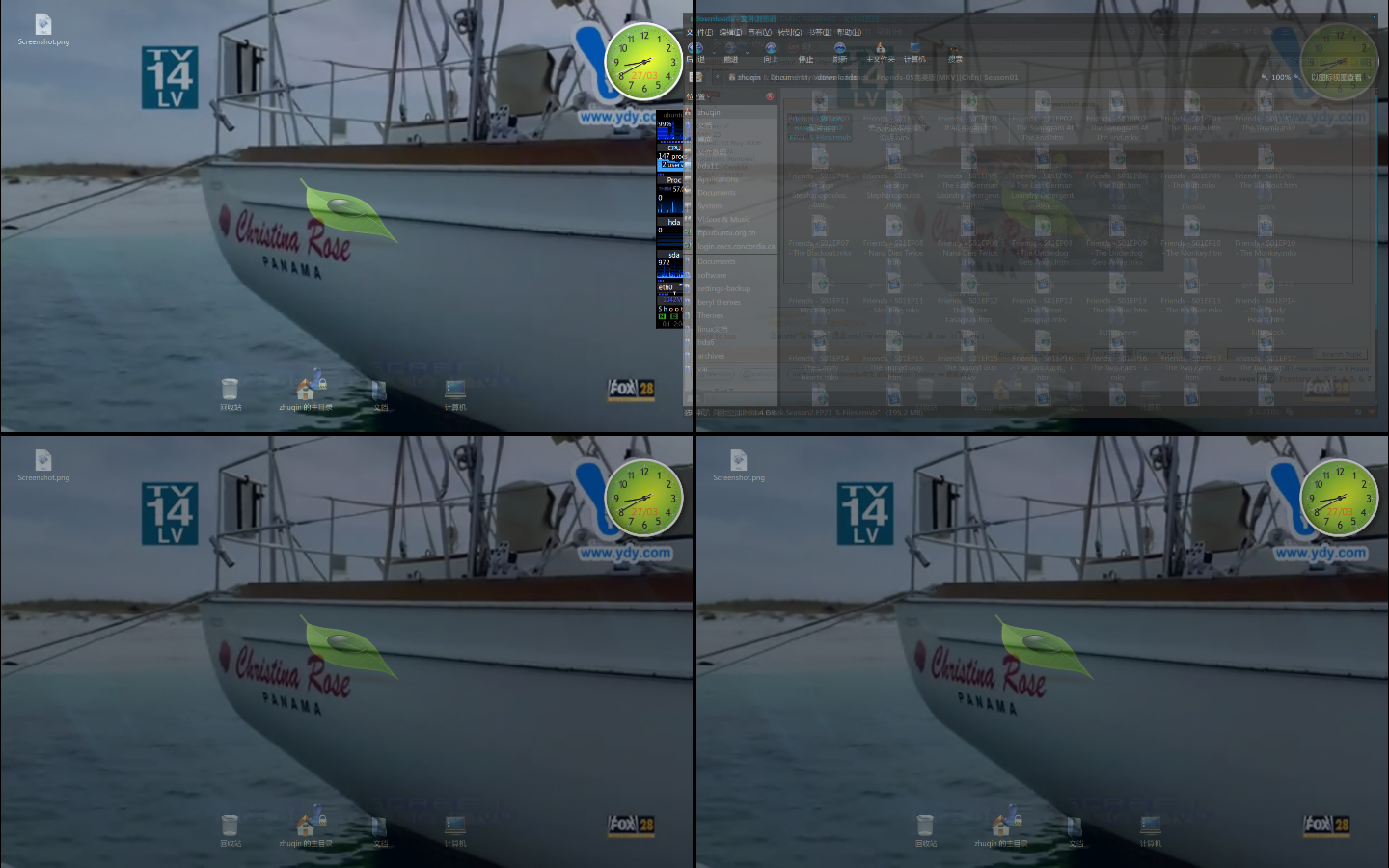

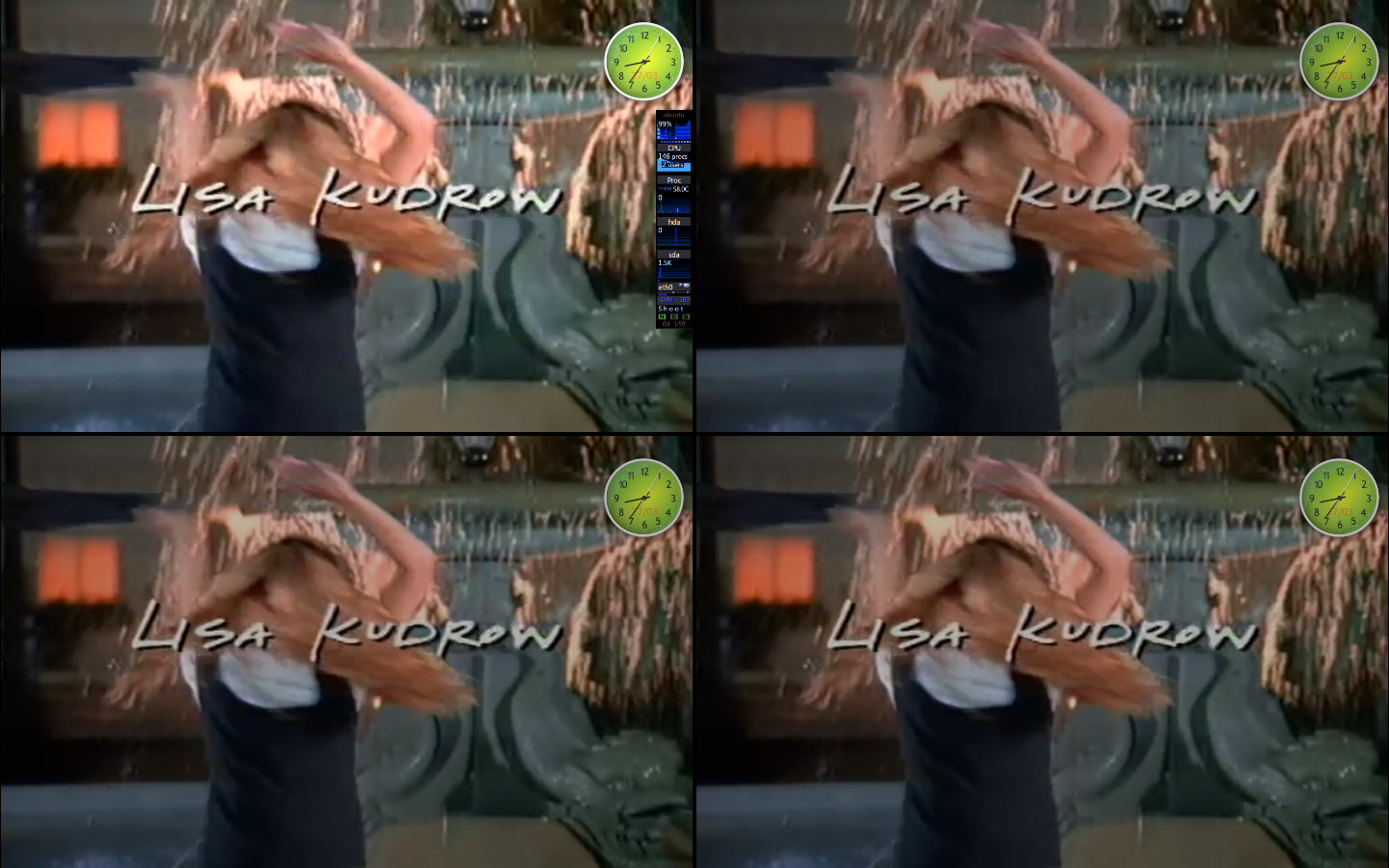

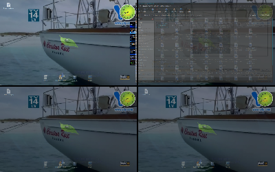

zhuqin_83
帖子: 10606
注册时间: 2006-05-13 4:02
#97
帖子 zhuqin_83 » 2007-03-28 8:37
见图:
DELL UltraSharp 2209WA
Arch64, Testing repo
