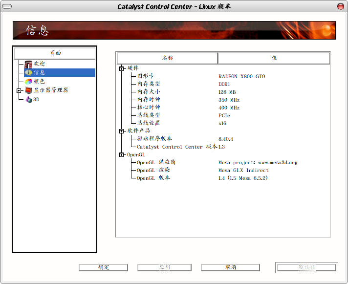

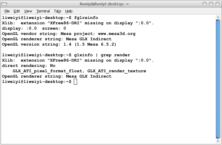

blackghost
帖子: 42
注册时间: 2007-03-18 18:35
#689
帖子 blackghost » 2007-08-31 11:13
zhuqin_83 写了:你再看看,可能那里跳了。
顺便把你的xorg.conf还有Xorg.0.log贴出来。
我又重新做了一遍,没有漏阿
我的xorg.conf如下,没有Xorg.0.log这个文件:
# /etc/X11/xorg.conf (xorg X Window System server configuration file)
# This file was generated by dexconf, the Debian X Configuration tool, using
# values from the debconf database.
# Edit this file with caution, and see the xorg.conf(5) manual page.
# (Type "man xorg.conf" at the shell prompt.)
# This file is automatically updated on xserver-xorg package upgrades *only*
# if it has not been modified since the last upgrade of the xserver-xorg
# package.
# If you have edited this file but would like it to be automatically updated
# again, run the following command:
# sudo dpkg-reconfigure -phigh xserver-xorg
Section "ServerLayout"
Identifier "Default Layout"
Screen 0 "aticonfig-Screen[0]" 0 0
InputDevice "Generic Keyboard"
InputDevice "Configured Mouse"
InputDevice "stylus" "SendCoreEvents"

zhuqin_83
帖子: 10606
注册时间: 2006-05-13 4:02
#690
帖子 zhuqin_83 » 2007-08-31 11:16
唉,又一个nforce的主板+ati显卡的。去看我首贴给出的trouble shooting吧。英文的。
