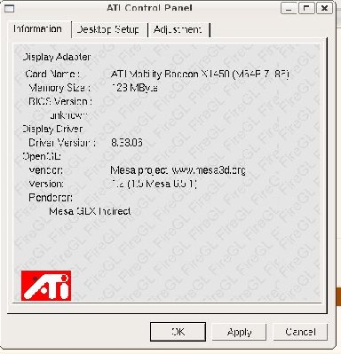

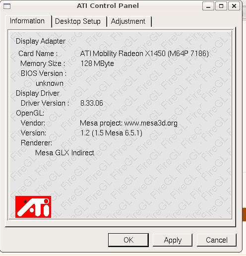

Asus A6Q22Je installed the driver following instructed method 2. But there's something wrong with it. The following is the output of fglrxinfo
raven@raven-laptop:~$ fglrxinfo
Xlib:  extension "XFree86-DRI" missing on display ":0.0".
display: :0.0  screen: 0
OpenGL vendor string: Mesa project: www.mesa3d.org
OpenGL renderer string: Mesa GLX Indirect
OpenGL version string: 1.2 (1.5 Mesa 6.5.1)
looks like my Mobility Radeon X1450 is not recognize correctly. Can anybody help me out?
Also here is a screenshot of the ati control panel
Sorry I just installed ubuntu and have no Chinese input method. Downloading fcitx now.
ATI Control Panel information
zhuqin_83
帖子: 10606
注册时间: 2006-05-13 4:02
#163
帖子 zhuqin_83 » 2007-02-09 15:48
sorry, ur video card is not supported at present.
check here:
