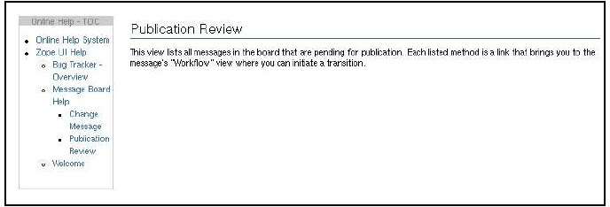

20.5 Step V: Writing a nice “Review Messages” View for Message Boards
20.5 步骤 V: 为消息栏编写一个好的“Review Messages”视图
Now that we have the basic workflow working, we should look at an example on how we can make use of the workflow mechanism. So the first task will be to provide the Editor with a nice overview over all pending messages from the message board object.
现在我们有一个正在运行的基本工作流,我们应该看一下怎样利用工作流机制的例子。因为第一个任务将是给编辑提供来自消息栏对象的所有待审消息的概要。
So we basically need a view class that recursively walks through the tree and and picks out the pending messages. To do this, it is extremely helpful to write a convenience function that simply checks whether a message has a certain status. The implementation could be something line the following, which we simply place into browser/messageboard.py:
因此我们基本上需要一个视图类用以递归遍历树并选出即将发生的消息。为了做到这点,编写一个函数简单地检查消息是否有某个状态就极为有用了。可以用下列语句实现,我们简单地将其放入 browser/messageboard.py中:

Next we are going to implement the view class, which will provide the method getPendingMessagesInfo() which will return a list of information structures for pending messages, where each info contains the title and the URL to the workflow view of the message. Place the following view in brower/messageboard.py:
接下来我们打算实现有着 getPendingMessagesInfo() 方法的视图类,该方法将为待审消息返回一个信息结构列表,在该列表中每个信息都包含标题和到消息工作流视图的 URL。

Next we create the template named review.pt that will display the pending messages:
接下来我们创建名为 review.pt 的模板,它将显示待审消息:

* Line 7-12: Iterate over all message entries and create links to each pending message, displaying its title.
* 第 7-12 行: 遍历所有消息条目并为每个待审消息创建链接和显示标题。
Finally, we just have to register the new view using simply:
最后,我们只须简单地注册新视图即可:
1 <page
2 name="review.html"
3 for="book.messageboard.interfaces.IMessageBoard"
4 class=".messageboard.ReviewMessages?"
5 permission="book.messageboard.PublishContent"
6 template="review.pt"
7 menu="zmi_views" title="Review Messages"/>
Now restart your Zope 3 server and enjoy the new view. You could do much more with this view, but this should give you an idea of the framework’s functionality.
现在重启你的 Zope 3 服务器享受你的新视图吧。你还可以用该视图做更多事,但它应该让你了解了整个架构的功能。

Now all you need to do is to restart Zope and go to a message board’s message review view. Like all management pages, there a “Help” link on the very right side below the tabs. Usually this link just brings you to the generic online help screen, but if you click on it from the message board’s review screen, you will see the help for this particular view. Another possibility would be to create special Message and MessageBoard object introduction screens, but I found this to be overkill in this situation.
现在你要做的就是重启 Zope 并到消息栏的消息查看视图。象所有的管理页面一样,在标签下面的右首有一个“Help” 链接。通常该链接只是带你到通用在线帮助屏幕,但如果你从消息栏的消息查看屏幕点它的话,你可以看到该指定视图的帮助。另一个可能是创建一个指定消息和消息栏对象的介绍屏幕,但我发现在这种情况下那样就显得过火了
详见附件
Figure 21.1: The help screen for the message board’s “Review Messages” tab.
图 21.1: 消息栏中 “Review Messages” 标签的帮助屏幕
