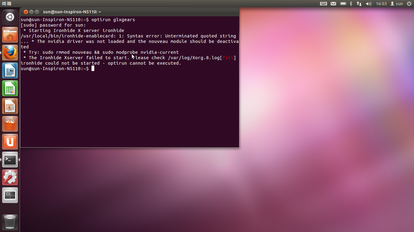

安装完成以后运行显示这个,/var/log/xorg.8.log信息如下:

这是肿么回事啊,搂主指点一下啊,因为显卡驱动安装失败已经重装了2次来,这个方法再不行的话,真得放弃ubuntu了 :em20 :em06
截图
截图

[ 939.985] (++) Using config file: "/etc/X11/xorg.conf.nvidia"
[ 939.985] (==) Using system config directory "/usr/share/X11/xorg.conf.d"
[ 939.986] (==) ServerLayout "Layout0"

[ 940.014] (EE) NVIDIA: Failed to load the NVIDIA kernel module. Please check your
[ 940.014] (EE) NVIDIA: system's kernel log for additional error messages.
[ 940.014] (II) UnloadModule: "nvidia"
[ 940.014] (II) Unloading nvidia
[ 940.014] (EE) Failed to load module "nvidia" (module-specific error, 0)

[ 940.016] (EE) No drivers available.
[ 940.016]
Fatal server error:
[ 940.016] no screens found
貌似是找不到显示器,我也是找来的办法,你试试:
修改 /etc/X11/xorg.conf.nvidia
修改
Option ConnectedMonitor CRT-0
Option ConnectedMonitor DFP-0
重启,再运行一遍
ironhide-configuration
