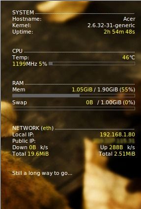

帖子 iamfbi » 2011-05-07 13:47
我的conky配置
会根据上网方式切换流量统计功能
# set to yes if you want Conky to be forked in the background
background no
cpu_avg_samples 4
net_avg_samples 2
out_to_console no
# Use Xft?
use_xft yes
# Xft font when Xft is enabled
xftfont Sans:size=8
own_window_transparent no

TEXT
${color white}SYSTEM $stippled_hr${color}
Hostname: $alignr$nodename
Kernel: $alignr$kernel
Uptime: $alignr${color yellow}$uptime${color}
${color white}CPU $stippled_hr${color}
Temp: ${alignr}${color yellow}${acpitemp}${color}℃
${color yellow}${freq}${color}MHz ${color yellow}${cpu cpu}${color}% ${color #666}${cpubar cpu}${color}
#CPU:1  ${cpu cpu1}% ${cpubar cpu1}
#CPU:2  ${cpu cpu2}% ${cpubar cpu2}
#CPU:3  ${cpu cpu3}% ${cpubar cpu3}
#CPU:4  ${cpu cpu4}% ${cpubar cpu4}
${color white}RAM $stippled_hr${color}
Mem ${alignr}${color yellow}$mem${color} / $memmax (${color yellow}$memperc${color}%)
${color #666}${membar 6}${color}
Swap ${alignr}${color yellow}$swap${color} / $swapmax (${color yellow}$swapperc${color}%)
${color #666}${swapbar 6}${color}
# |--WLAN0
${if_up wlan0}${voffset -13}
${color white}NETWORK (${color yellow}wlan${color}) $stippled_hr${color}
Local IP: ${alignr}${color yellow}${addr wlan0}${color}
Public IP: ${alignr}${color yellow}${execi 1800 wget -q -O - checkip.dyndns.org | sed -e 's/[^[:digit:]\|.]//g'}${color}
Down ${color yellow}${downspeed wlan0}${color} k/s ${alignr}Up ${color yellow}${upspeed wlan0}${color} k/s
Total ${color yellow}${totaldown wlan0}${color} ${alignr}Total ${color yellow}${totalup wlan0}${color}
# |--PPP0
${else}${if_up ppp0}${voffset -13}
${color white}NETWORK (${color yellow}ppp${color}) $stippled_hr${color}
Local IP: ${alignr}${color yellow}${addr ppp0}${color}
Down ${color yellow}${downspeed ppp0}${color} k/s ${alignr}Up ${color yellow}${upspeed ppp0}${color} k/s
Total ${color yellow}${totaldown ppp0}${color} ${alignr}Total ${color yellow}${totalup ppp0}${color}
# |--ETH0
${else}${if_up eth0}${voffset -13}
${color white}NETWORK (${color yellow}eth${color}) $stippled_hr${color}
Local IP: ${alignr}${color yellow}${addr eth0}${color}
Down ${color yellow}${downspeed eth0}${color} k/s ${alignr}Up ${color yellow}${upspeed eth0}${color} k/s
Total ${color yellow}${totaldown eth0}${color} ${alignr}Total ${color yellow}${totalup eth0}${color}
${endif}${endif}${endif}
Still a long way to go...
