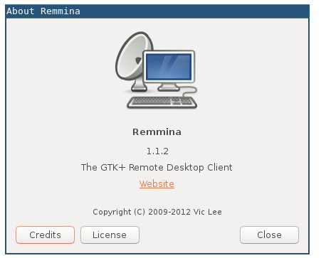

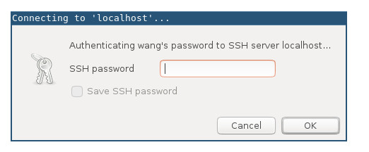

16.04带的remmina1.1.2为何不能保存ssh密码
- 帖子: 18279
- 注册时间: 2009-08-04 16:33
Re: 16.04带的remmina1.1.2为何不能保存ssh密码
https://github.com/FreeRDP/Remmina/issu ... -357749860
Did you install gnome-keyring?
https://github.com/FreeRDP/Remmina/issu ... -357753141
you can remove the "remmina-plugin-secret" plugin
https://github.com/FreeRDP/Remmina/issu ... -367331360
With snap you have to enable the keyring
- 帖子: 93
- 注册时间: 2007-10-11 22:03
用snap装的新版可以了,apt装的老版不知道咋回事,还是不行
