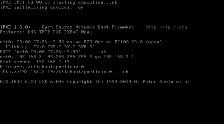

最近折腾了两个小主机,华硕EeeBox B202,atom n270的u,1g的内存,80g的硬盘,机器挺小巧,就是单核u,功能实在鸡肋,索性一个做了个播放机,这个就做了一个pxe server!
利用wol的功能,网络装系统,至于pxe的原理,如下:

1:首先,需要的工具包有 dnsmasq,samba, nfs-utils,openssh,syslinux
dnsmasq = 充当dhcp和tftpserver
samba = 安装windows使用,另外也为了方便windows机器管理
nfs-utils = 加载linux镜像用
openssh = 管理用,ssh登录很方便,毕竟这台机器是个小的服务器吧
syslinux = 启动pxelinux以及各种启动程序
arch下很简单,一条命令
pacman -S dnsmasq samba nfs-utils openssh syslinux
2:然后就是配置dhcp和tftp server,以及nfs 和 ssh server了
直接贴配置文件比较省事
dnsmasq为了配置方便,我在/etc/dnsmasq.d/重建了一个pxe.conf的配置文件,配置如下
记住要把/etc/dnsmasq.conf里面下面这句话取消注释
# Include another lot of configuration options.
#conf-file=/etc/dnsmasq.more.conf
conf-dir=/etc/dnsmasq.d
#     function as a tftp server 启动tftpserver
enable-tftp
#     root directory for files available via ftp. ftp的root环境
tftp-root=/tftpboot
#     the boot filename
#pxe-service=X86PC,"PXE Boot Menu",pxelinux 启动文件
dhcp-boot=/tftpboot/pxelinux.0
#     kill multicast
#dhcp-option=vendor:PXEClient,6,2b
#     disable reuse of the dhcp servername and filename fields as extra.
#     option space. to avoid confusing some old or broken dhcp clients.
dhcp-no-override
#     This range(s) is for the public interface, where dnsmasq functions
#     as a proxy DHCP server providing boot information but no IP leases.
#     Any ip in the subnet will do, so you may just put your server NIC ip here.
#     I used my router ip address
#dhcp-range=192.168.2.1,proxy,255.255.255.0
#dhcp-range=192.168.2.100,proxy
# do not give IPs that are in pool of DSL routers DHCP 我避开了家里路由器的dhcp缺省池
dhcp-range=192.168.2.151,192.168.2.200,12h
#     router/gateway ip address
dhcp-option=3,192.168.2.1
#     dns server ip address
dhcp-option=6,192.168.2.1
#     enable logging
log-dhcp
log-queries
samba的配置文件smb.conf
在windows下直接在文件浏览器中打入\\192.168.2.19,就可以打开tftpboot文件夹,直接管理里面的文件

期间还自己学会了自制winpe,我做了2个版本的winpe,一个32位,一个64位.
最后,只要把要安装的机器修改为网卡启动,就可以进入我配置的pxe server了
如下图
oneleaf
