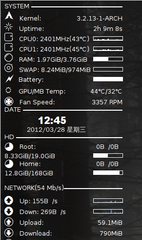

extra/conky就可以,所谓霸气是指什么样子?这样的行不?
附件:
2012-03-28-12-45-37_291x490.jpg [ 128.62 KiB | 被浏览 922 次 ]

不错,非常实用嗷。再问下,显示温度、风扇转速的话要装其他的包吗?
“霸气”的话……“霸”占桌面,该居中的居中,因为可能是使用习惯的问题吧,换到gnome3之后就没有什么侧边拦的概念了,而且桌面也太干净了,想要丰富一下。(最好能跟中央的那个Arch Logo呼应一下,记得以前看到篇文章(帖子?)写国外牛人的桌面什么的,那个conky配置很赞,现在找不到了)

一般来说不需要。我的配置如下:
代码:
# Use Xft?
use_xft yes
xftfont Sans:size=10
xftalpha 0.8
text_buffer_size 2048
# Update interval in seconds
update_interval 1
# This is the number of times Conky will update before quitting.
# Set to zero to run forever.
total_run_times 0
# Create own window instead of using desktop (required in nautilus)
own_window no
own_window_transparent yes
own_window_type override
#own_window_hints undecorated,below,sticky,skip_taskbar,skip_pager
# Use double buffering (reduces flicker, may not work for everyone)
double_buffer yes
# Minimum size of text area
minimum_size 180 0
#maximum_width 200
# How strict should if_up be when testing an interface for being up? The value is one of up, link or address
if_up_strictness link
# Draw shades?
draw_shades no
# Draw outlines?
draw_outline no
# Draw borders around text
draw_borders no
# Stippled borders?
stippled_borders 0
# border margins
#window.border_inner_margin 5
# border width
border_width 1
# Default colors and also border colors
default_color white
#default_shade_color black
#default_outline_color white
#own_window_colour white
# Text alignment, other possible values are commented
alignment top_left
#alignment top_right
#alignment bottom_left
#alignment bottom_right
# Gap between borders of screen and text
# same thing as passing -x at command line
gap_x 35
gap_y 50
# Subtract file system buffers from used memory?
no_buffers yes
# set to yes if you want all text to be in uppercase
uppercase no
# number of cpu samples to average
# set to 1 to disable averaging
cpu_avg_samples 2
# number of net samples to average
net_avg_samples 2
# Force UTF8? note that UTF8 support required XFT
override_utf8_locale yes
# Add spaces to keep things from moving about?  This only affects certain objects.
use_spacer none
#Update interval when running on batterypower
update_interval_on_battery 1
TEXT
SYSTEM ${hr 2}
${voffset 2}${font OpenLogos:size=16}A${font}   Kernel:  ${alignr}${kernel}
${font StyleBats:size=16}q${font}   Uptime: ${alignr}${uptime}
${font StyleBats:size=16}A${font}   CPU0: ${freq cpu1}MHz(${ibm_temps 0}℃)${alignr}${cpugraph cpu1 8,60 -t}
${font StyleBats:size=16}A${font}   CPU1: ${freq cpu2}MHz(${ibm_temps 1}℃)${alignr}${cpugraph cpu2 8,60 -t}
${font StyleBats:size=16}g${font}   RAM: $mem/$memmax ${alignr}${membar 8,60}
${font StyleBats:size=16}j${font}   SWAP: $swap/$swapmax ${alignr}${swapbar 8,60}
${font Webdings:size=16}~${font}  Battery: ${battery_time BAT0} ${alignr}${battery_bar 8,60 BAT0}
${voffset 4}${font Wingdings:size=14}R${font}   GPU/MB Temp: ${alignr}${ibm_temps 3}℃/${ibm_temps 4}℃
${voffset 4}${font PizzaDude Bullets:size=14}_${font}   Fan Speed: ${alignr}${ibm_fan} RPM
DATE ${hr 2}
${alignc 35}${font Arial Black:size=15}${time %R}${font}
${alignc 25}${font WenQuanYi Zen Hei:size=10}${time %Y/%m/%d %A}${font}
HD ${hr 2}
${voffset 4}${font Pie charts for maps:size=14}7${font}   ${voffset -5}Root:${alignr}${diskio_read sda7}/${diskio_write sda7}
${voffset 4}${fs_free /}/${fs_size /} ${alignr}${fs_bar 8,60 /}
${font Pie charts for maps:size=14}7${font}   ${voffset -5}Home:${alignr}${diskio_read sda9}/${diskio_write sda9}
${voffset 4}${fs_free /home}/${fs_size /home} ${alignr}${fs_bar 8,60 /home}
${if_up eth0}
NETWORK${hr 2}
${voffset -6}${font PizzaDude Bullets:size=14}O${font}   Up: ${upspeed eth0}/s ${alignr}${upspeedgraph eth0 8,60 3465A4 729FCF}
${voffset 4}${font PizzaDude Bullets:size=14}U${font}   Down: ${downspeed eth0}/s ${alignr}${downspeedgraph eth0 8,60 3465A4 729FCF}
${voffset 4}${font PizzaDude Bullets:size=14}N${font}   Upload: ${alignr}${totalup eth0}
${voffset 4}${font PizzaDude Bullets:size=14}T${font}   Download: ${alignr}${totaldown eth0}
${voffset 4}${font PizzaDude Bullets:size=14}Z${font}   Signal: ${wireless_link_qual eth0}% ${alignr}${wireless_link_bar 8,60 eth0}
${voffset 4}${font PizzaDude Bullets:size=14}a${font}   Local Ip: ${alignr}${addr eth0}
${voffset 4}${font PizzaDude Bullets:size=14}b${font}   Public Ip: ${alignr}${execi 600 ~/.conky/scripts/ip.sh}
${else}${if_up wlan0}
NETWORK(${wireless_bitrate wlan0})${hr 2}
${voffset -6}${font PizzaDude Bullets:size=14}O${font}   Up: ${upspeed wlan0}/s ${alignr}${upspeedgraph wlan0 8,60 3465A4 729FCF}
${voffset 4}${font PizzaDude Bullets:size=14}U${font}   Down: ${downspeed wlan0}/s ${alignr}${downspeedgraph wlan0 8,60 3465A4 729FCF}
${voffset 4}${font PizzaDude Bullets:size=14}N${font}   Upload: ${alignr}${totalup wlan0}
${voffset 4}${font PizzaDude Bullets:size=14}T${font}   Download: ${alignr}${totaldown wlan0}
${voffset 4}${font PizzaDude Bullets:size=14}a${font}   Local Ip: ${alignr}${addr wlan0}
${else}${if_up ppp0}
NETWORK${hr 2}
${voffset -6}${font PizzaDude Bullets:size=14}O${font}   Up: ${upspeed ppp0}/s ${alignr}${upspeedgraph ppp0 8,60 3465A4 729FCF}
${voffset 4}${font PizzaDude Bullets:size=14}U${font}   Down: ${downspeed ppp0}/s ${alignr}${downspeedgraph ppp0 8,60 3465A4 729FCF}
${voffset 4}${font PizzaDude Bullets:size=14}N${font}   Upload: ${alignr}${totalup ppp0}
${voffset 4}${font PizzaDude Bullets:size=14}T${font}   Download: ${alignr}${totaldown ppp0}
${voffset 4}${font PizzaDude Bullets:size=14}a${font}   Local Ip: ${alignr}${addr ppp0}
${endif}${endif}${endif}
TOP ${hr 2}
Name              PID     CPU%   MEM%
${top name 1} ${top pid 1} ${top cpu 1} ${top mem 1}
${top name 2} ${top pid 2} ${top cpu 2} ${top mem 2}
${top name 3} ${top pid 3} ${top cpu 3} ${top mem 3}
MEMORY ${hr 2}
${top_mem name 1} ${top_mem pid 1} ${top_mem cpu 1} ${top_mem  mem 1}
${top_mem name 2} ${top_mem pid 2} ${top_mem cpu 2} ${top_mem    mem 2}
${top_mem name 3} ${top_mem pid 3} ${top_mem cpu 3} ${top_mem    mem 3}
