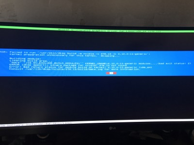

4)检查nouveau driver确保没有被加载!
$ lsmod | grep nouveau
lz是缺失了驱动的依赖kernel-devel。首先要安装kernel-devel才能继续安装驱动。不过kernel-devel是rpm的东西。
在ubuntu下,安装的不一样,打开终端,输入sudo apt-get install linux-headers-generic,安装好之后再安装驱动。
sudo apt-get install linux-source
报错the distribution-provided pre-install script failed!不必理会,继续安装;
For example:
The distribution-provided pre-install script failed!
Failed to install the kernel module through DKMS.
ERROR: Unable to find the kernel source tree for
the currently running kernel. Please make sure
you have installed the kernel source files for
your kernel and that they are properly configured;
on Red Hat Linux systems, for example, be sure you
have the 'kernel-source' or 'kernel-devel' RPM
installed. If you know the correct kernel source
files are installed, you may specify the kernel
source path with the '--kernel-source-path' command
line option.
sh NVIDIAxxx --kernel-source-path=/usr/src/kernels/x.xx.x-xxxx
其中 NVIDIAxxx 为 nvidia 驱动脚本文件, x.xx.x-xxxx 为 kernel 版本号。
sudo ./cuda_6.5.14_linux_64.run --kernel-source-path=/usr/src/linux-headers-`uname -r`/
ls /usr/src/linux-headers/$(uname -r)
ERROR: Failed to run `/usr/sbin/dkms build -m nvidia -v 304.22 -k
3.5.0-21-generic`: Error! Your kernel headers for kernel
3.5.0-21-generic cannot be found.
Please install the linux-headers-3.5.0-21-generic package,
or use the --kernelsourcedir option to tell DKMS where it's located
ERROR: Failed to install the kernel module through DKMS. No kernel module
was installed; please try installing again without DKMS, or check the
DKMS logs for more information.
ERROR: Installation has failed. Please see the file
'/var/log/nvidia-installer.log' for details. You may find
suggestions on fixing installation problems in the README available
on the Linux driver download page at www.nvidia.com.
sudo apt-get install dkms build-essential linux-headers-$(uname -r)

给NVIDIA驱动打补丁(可以使用ryzen的4.10内核与Nvidia 378.13兼容性不好导致了一个bug出现)
cd ~/Downloads
sudo sh NVIDIA-*.run -x
cd ~/Downloads/NV*13
sudo patch -p1 <<< $(curl https://gist.githubusercontent.com/tpru ... tfile1.txt)
参考文:1:https://devtalk.nvidia.com/default/topi ... rnel-4-10/

nvidia-installer log file '/var/log/nvidia-installer.log'
creation time: Mon Mar 13 10:23:31 2017
installer version: 378.13
PATH: /usr/local/sbin:/usr/local/bin:/usr/sbin:/usr/bin:/sbin:/bin:/snap/bin
nvidia-installer command line:
./nvidia-installer
Unable to load: nvidia-installer ncurses v6 user interface
Using: nvidia-installer ncurses user interface
-> Detected 16 CPUs online; setting concurrency level to 16.
-> License accepted.
-> Installing NVIDIA driver version 378.13.
-> Running distribution scripts
executing: '/usr/lib/nvidia/pre-install'...
-> done.
-> The distribution-provided pre-install script failed! Are you sure you want to continue? (Answer: Continue installation)
-> Would you like to register the kernel module sources with DKMS? This will allow DKMS to automatically build a new module, if you install a different kernel later. (Answer: Yes)
-> Installing both new and classic TLS OpenGL libraries.
-> Installing both new and classic TLS 32bit OpenGL libraries.
-> Install NVIDIA's 32-bit compatibility libraries? (Answer: Yes)
-> Will install GLVND GLX client libraries.
-> Will install GLVND EGL client libraries.
-> Skipping GLX non-GLVND file: "libGL.so.378.13"
-> Skipping GLX non-GLVND file: "libGL.so.1"
-> Skipping GLX non-GLVND file: "libGL.so"
-> Skipping EGL non-GLVND file: "libEGL.so.378.13"
-> Skipping EGL non-GLVND file: "libEGL.so"
-> Skipping EGL non-GLVND file: "libEGL.so.1"
-> Skipping GLX non-GLVND file: "./32/libGL.so.378.13"
-> Skipping EGL non-GLVND file: "./32/libEGL.so.378.13"
Looking for install checker script at ./libglvnd_install_checker/check-libglvnd-install.sh
executing: '/bin/sh ./libglvnd_install_checker/check-libglvnd-install.sh'...
Checking for libglvnd installation.
Checking libGLdispatch...
Can't load library libGLdispatch.so.0: libGLdispatch.so.0: cannot open shared object file: No such file or directory
Will install libglvnd libraries.
Will install libEGL vendor library config file to /usr/share/glvnd/egl_vendor.d
-> Searching for conflicting files:
-> done.
-> Installing 'NVIDIA Accelerated Graphics Driver for Linux-x86_64' (378.13):
executing: '/sbin/ldconfig'...
-> done.
-> Driver file installation is complete.
-> Installing DKMS kernel module:
ERROR: Failed to run `/usr/sbin/dkms build -m nvidia -v 378.13 -k 4.10.0-11-generic`:
Kernel preparation unnecessary for this kernel. Skipping...
Building module:
cleaning build area...
'make' -j16 NV_EXCLUDE_BUILD_MODULES='' KERNEL_UNAME=4.10.0-11-generic modules....(bad exit status: 2)
ERROR (dkms apport): binary package for nvidia: 378.13 not found
Error! Bad return status for module build on kernel: 4.10.0-11-generic (x86_64)
Consult /var/lib/dkms/nvidia/378.13/build/make.log for more information.
-> error.
ERROR: Failed to install the kernel module through DKMS. No kernel module was installed; please try installing again without DKMS, or check the DKMS logs for more information.
ERROR: Installation has failed. Please see the file '/var/log/nvidia-installer.log' for details. You may find suggestions on fixing installation problems in the README available on the Linux driver download page at www.nvidia.com.
cd ~/Downloads

/var/lib/dkms/nvidia/378.13/build/nvidia/nv-pat.c: In function ‘nv_init_pat_support’:
/var/lib/dkms/nvidia/378.13/build/common/inc/nv-linux.h:391:34: error: implicit declaration of function ‘register_cpu_notifier’ [-Werror=implicit-function-declaration]
#define register_hotcpu_notifier register_cpu_notifier
/var/lib/dkms/nvidia/378.13/build/nvidia/nv-pat.c:258:17: note: in expansion of macro ‘register_hotcpu_notifier’
if (register_hotcpu_notifier(&nv_hotcpu_nfb) != 0)
/var/lib/dkms/nvidia/378.13/build/nvidia/nv-pat.c: In function ‘nv_teardown_pat_support’:
/var/lib/dkms/nvidia/378.13/build/common/inc/nv-linux.h:388:36: error: implicit declaration of function ‘unregister_cpu_notifier’ [-Werror=implicit-function-declaration]
#define unregister_hotcpu_notifier unregister_cpu_notifier
/var/lib/dkms/nvidia/378.13/build/nvidia/nv-pat.c:283:9: note: in expansion of macro ‘unregister_hotcpu_notifier’
unregister_hotcpu_notifier(&nv_hotcpu_nfb);
cc1: some warnings being treated as errors
scripts/Makefile.build:294*: la recette pour la cible «*/var/lib/dkms/nvidia/378.13/build/nvidia/nv-pat.o*» a échouée
make[2]: *** [/var/lib/dkms/nvidia/378.13/build/nvidia/nv-pat.o] Erreur 1
make[2]: *** Attente des tâches non terminées....
Makefile:1496*: la recette pour la cible «*_module_/var/lib/dkms/nvidia/378.13/build*» a échouée
make[1]: *** [_module_/var/lib/dkms/nvidia/378.13/build] Erreur 2
make[1]*: on quitte le répertoire «*/usr/src/linux-headers-4.10.0-041000rc8-generic*»
Makefile:81*: la recette pour la cible «*modules*» a échouée
make: *** [modules] Erreur 2
