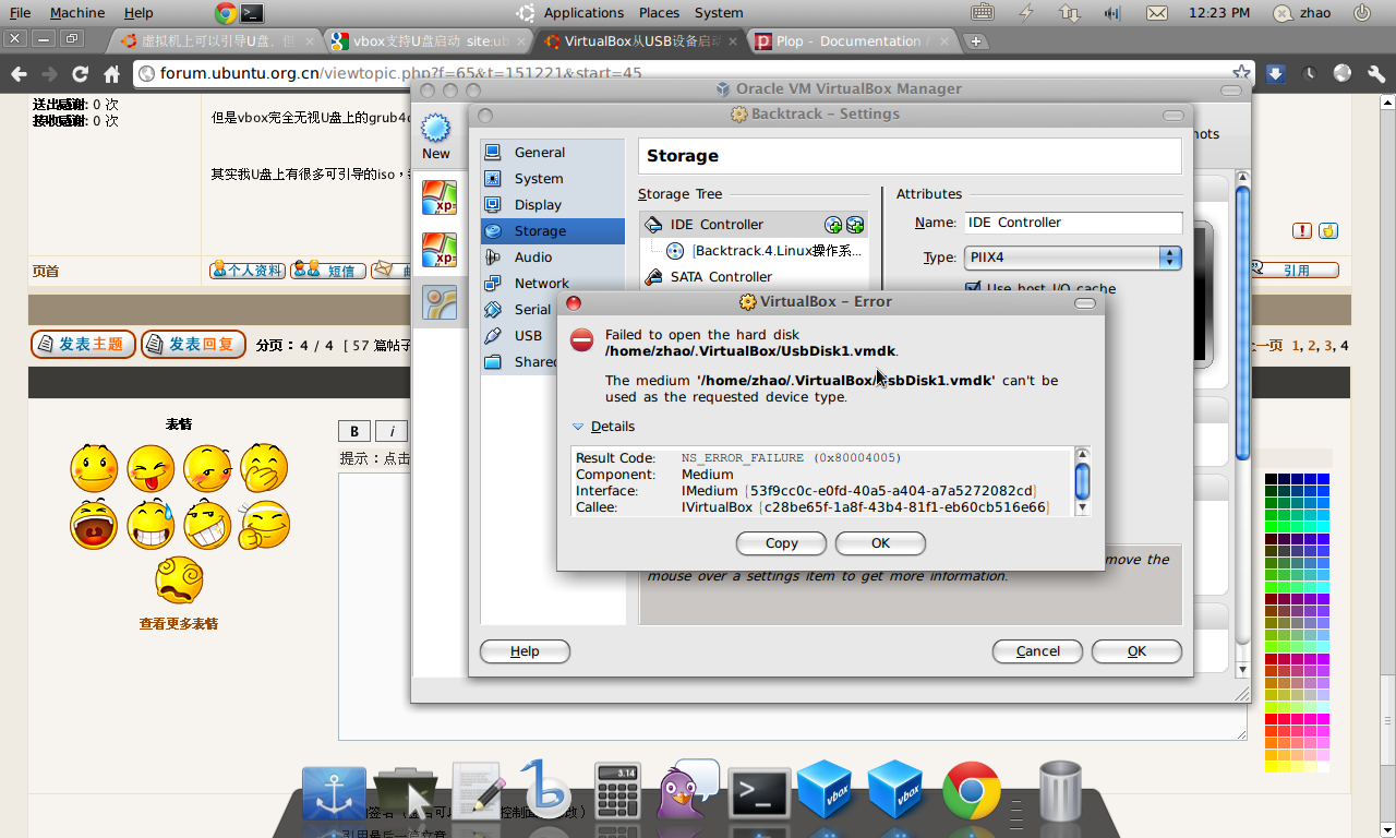

Failed to open the hard disk /home/zhao/.VirtualBox/UsbDisk1.vmdk.
The medium '/home/zhao/.VirtualBox/UsbDisk1.vmdk' can't be used as the requested device type.
Result Code:
NS_ERROR_FAILURE (0x80004005)
Component:
Medium
Interface:
IMedium {53f9cc0c-e0fd-40a5-a404-a7a5272082cd}
Callee:
IVirtualBox {c28be65f-1a8f-43b4-81f1-eb60cb516e66}
zhaoqingyu51
帖子: 120
注册时间: 2011-10-02 21:06
Re: VirtualBox从USB设备启动方法
#59
帖子 zhaoqingyu51 » 2012-03-09 12:27
求解决。。已经成功创建了硬盘文件,u盘是不是先要unmount一下?
