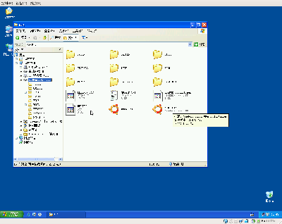

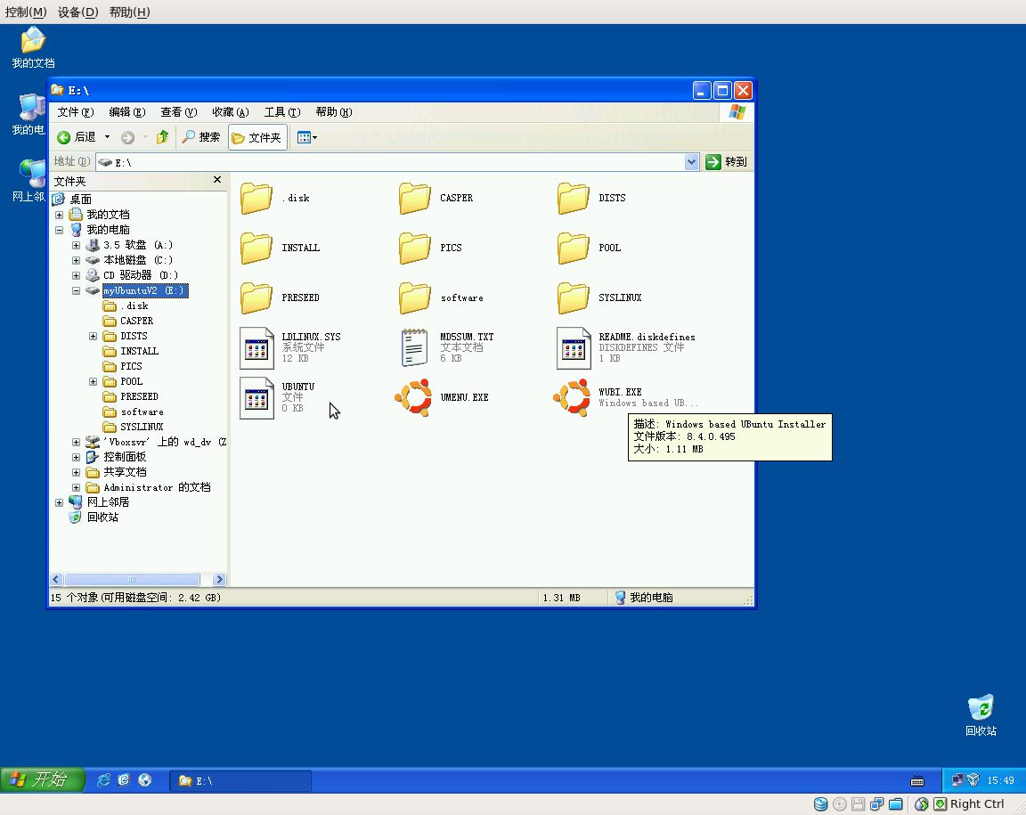

另,用的就是
代码:
Ubuntu软件库里那个VirtualBox OSE版
 用户资料
9 楼
 文章标题 : Re: VirtualBox从USB设备启动方法
帖子发表于 : 2008-10-29 15:55
注册: 2007-07-08 19:21
帖子: 145
送出感谢: 0 次
接收感谢: 0 次
代码:
[email protected]:~/桌面$ sudo usermod -G vboxusers -a `whoami`
[sudo] password for feng:
[email protected]:~/桌面$ sudo chmod o+rw /dev/sdc
[email protected]:~/桌面$ VBoxManage internalcommands createrawvmdk -filename ~/.VirtualBox/VDI/UsbDisk.vmdk -rawdisk /dev/sdc -register
VirtualBox Command Line Management Interface Version 2.0.4_OSE
(C) 2005-2008 Sun Microsystems, Inc.
All rights reserved.
RAW host disk access VMDK file /home/feng/.VirtualBox/VDI/UsbDisk.vmdk created successfully.

:em01 :em01 :em01
