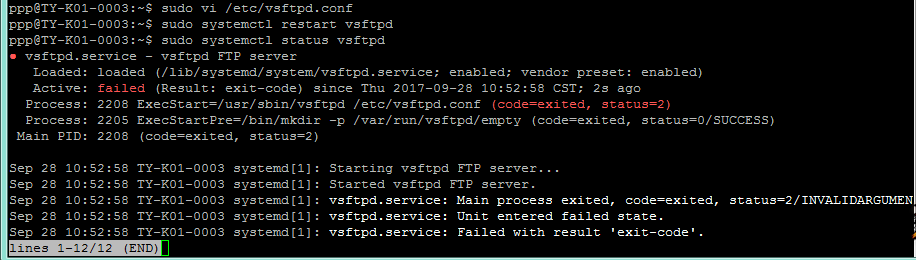

ubuntu16.10 server vsftpd问题,listen=no可以启动改成YES启动不了。
是不是和xinetd有关,ubuntu16.10自带xindtd吗。

Re: ubuntu16.10 server vsftpd问题,listen=no可以启动改成YES启动不了。
服务状态:
ppp@TY-K01-0003:~$ sudo systemctl restart vsftpd
ppp@TY-K01-0003:~$ sudo systemctl status vsftpd
● vsftpd.service - vsftpd FTP server
Loaded: loaded (/lib/systemd/system/vsftpd.service; enabled; vendor preset: enabled)
Active: failed (Result: exit-code) since Thu 2017-09-28 11:15:10 CST; 1s ago
Process: 2348 ExecStart=/usr/sbin/vsftpd /etc/vsftpd.conf (code=exited, status=2)
Process: 2345 ExecStartPre=/bin/mkdir -p /var/run/vsftpd/empty (code=exited, status=0/SUCCESS)
Main PID: 2348 (code=exited, status=2)
Sep 28 11:15:10 TY-K01-0003 systemd[1]: Starting vsftpd FTP server...
Sep 28 11:15:10 TY-K01-0003 systemd[1]: Started vsftpd FTP server.
Sep 28 11:15:10 TY-K01-0003 systemd[1]: vsftpd.service: Main process exited, code=exited, status=2/INVALIDARGUMENT
Sep 28 11:15:10 TY-K01-0003 systemd[1]: vsftpd.service: Unit entered failed state.
Sep 28 11:15:10 TY-K01-0003 systemd[1]: vsftpd.service: Failed with result 'exit-code'.

"/etc/vsftpd.conf" 155 lines, 5848 characters
手动启动vsftpd:
ppp@TY-K01-0003:~$ sudo vi /etc/vsftpd.conf
ppp@TY-K01-0003:~$ sudo service vsftpd restart
Active: active (running) since Thu 2017-09-28 11:21:35 CST; 3s ago
Process: 2422 ExecStartPre=/bin/mkdir -p /var/run/vsftpd/empty (code=exited, status=0/SUCCESS)
Main PID: 2425 (vsftpd)
Tasks: 1 (limit: 4915)
CGroup: /system.slice/vsftpd.service
└─2425 /usr/sbin/vsftpd /etc/vsftpd.conf
Sep 28 11:21:35 TY-K01-0003 systemd[1]: Starting vsftpd FTP server...
Sep 28 11:21:35 TY-K01-0003 systemd[1]: Started vsftpd FTP server.
ppp@TY-K01-0003:~$

手动启动vsftpd:
ppp@TY-K01-0003:~$
