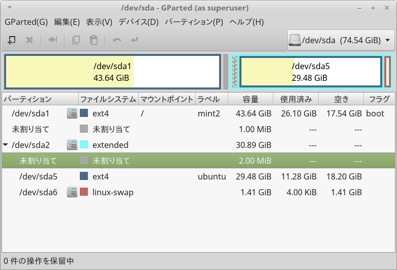

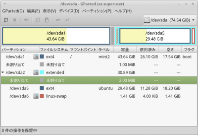

なんかおかしい。まず、/dev/sda1: LABEL="mint2"  がない
有些事情是错的。 首先,没有/ dev / sda 1:LABEL =“mint 2”
$ sudo blkid
/dev/sda1: LABEL="mint2" UUID="3fb1c77c-7d46-4243-a955-790755e6023b" TYPE="ext4" PARTUUID="00077759-01"
/dev/sda5: LABEL="ubuntu" UUID="fdbadeb3-1cf6-4d23-9a83-61d080ba2afe" TYPE="ext4" PARTUUID="00077759-05"
/dev/sda6: UUID="4fb6dfed-1bc3-477a-8170-84e156766b4c" TYPE="swap" PARTUUID="00077759-06"
jin@1:~$

1. You must change the following two lines
# / was on /dev/sda6 during installation
UUID=fdbadeb3-1cf6-4d23-9a83-61d080ba2afe / ext4 errors=remount-ro 0 1
to
# / was on /dev/sda5 during installation
# /etc/fstab: static file system information.
# swap was on /dev/sda5 during installation
UUID=b27697f1-613f-485f-be6e-e1e5b65f1b14 none swap sw 0 0
sudo ls -al /dev/disk/by-uuid/*
lrwxrwxrwx 1 root root 10 5月 30 13:14 /dev/disk/by-uuid/4fb6dfed-1bc3-477a-8170-84e156766b4c -> ../../sda6
sudo blkid
2. You must change the following two lines
UUID=4fb6dfed-1bc3-477a-8170-84e156766b4c none swap sw 0 0
to
# swap was on /dev/sda6 during installation

jin@1:~$ sudo fdisk -l
[sudo] password for jin:
Disk /dev/sda: 74.5 GiB, 80032038912 bytes, 156312576 sectors
Units: sectors of 1 * 512 = 512 bytes
Sector size (logical/physical): 512 bytes / 512 bytes
I/O size (minimum/optimal): 512 bytes / 512 bytes
Disklabel type: dos
Disk identifier: 0x00077759
Device Boot Start End Sectors Size Id Type
/dev/sda1 * 2048 91521023 91518976 43.7G 83 Linux
/dev/sda2 91523072 156312575 64789504 30.9G 5 Extended
/dev/sda5 91527168 153352191 61825024 29.5G 83 Linux
/dev/sda6 153354240 156311551 2957312 1.4G 82 Linux swap / Solaris
jin@1:~$

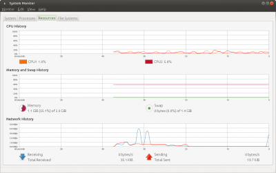

今回の作業をしても、「起動直後1.1GBメモリ使用。もうすぐ大量のスワップで応答停止」の症状は、改善しない
即使這項工作已經完成,“啟動後立即停止使用1.1 GB內存並很快停止大量SWAP”的症狀不會改善
HELP ありがとうございます謝謝
起動直後メモリ使用量<br />Memory usage immediately after startup
起動直後メモリ使用量

sudo blkid
/dev/sda1: ... PARTUUID="00077759-01"
/dev/sda5: ... PARTUUID="00077759-05"
/dev/sda6: ... PARTUUID="00077759-06"
sudo fdisk -l
1. Disk identifier: 0x00077759
https://en.wikipedia.org/wiki/Partition ... tition_IDs
List of partition IDs
82h : Swap / Solaris x86 / Prime Computer
2. The same Partition_type ID : 82h

$ gksu pluma /etc/fstab
1. gksu is used when you logged-in with user root, that is not recommended.
2. gksudo is used when you logged-in with user non-root, that is recommended.
sudo blkid
$ swapon -s
Filename Type Size Used Priority
/dev/sda6 partition 1478652 0 -1
3. The line beginning with # means this line will be ignored.
i.e. this line
will be ignored.
あれ?swapon -s の値と、fstabの​swap の位置が違いはしまいか?
那一個? swapon - s的值是否與fstab的交換位置不同?
4. viewtopic.php?p=3206153#p3206153
to
4-1. This line takes effect.
4-2. sudo swapon -s & /etc/fstab
is the same result : /dev/sda6.
